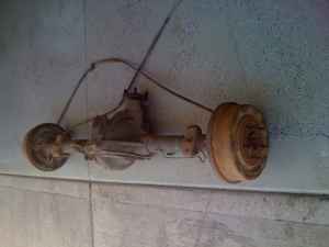

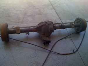

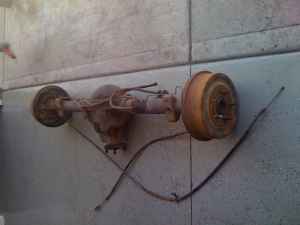

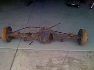

I have attached pics of a 8.8 low pinion ford rear end out of a bronco 2, YES...A 1990 2WD Bronco 2. Its 58-1/2" from outside drum to drum with 3.73 gears. Has not been narrowed, 5 on 4-1/2 bolt pattern. Putting it under my 85 B2, changing gears out first. I found it bolted up under a 2WD b2 in a field for the better part of 20 years. No ID tag on it but I mesured the ring and pinion so I can change them out, only problem is it's an open diff!

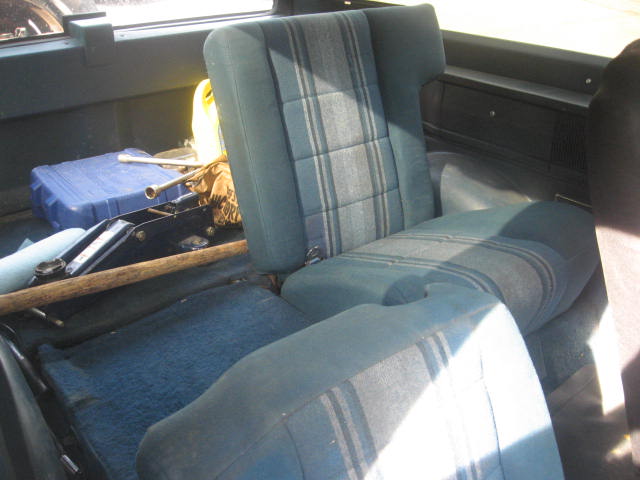

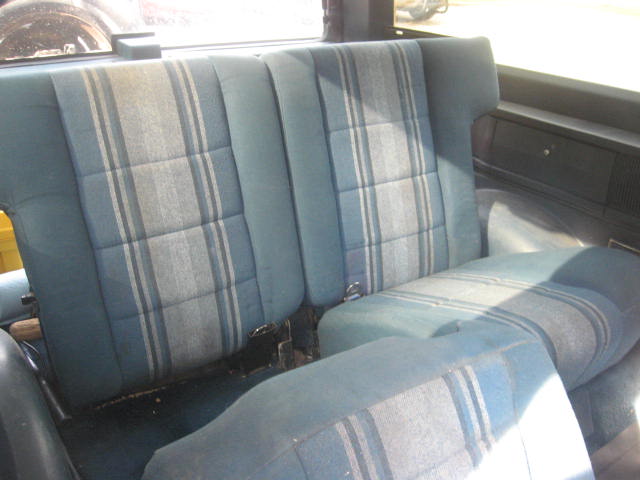

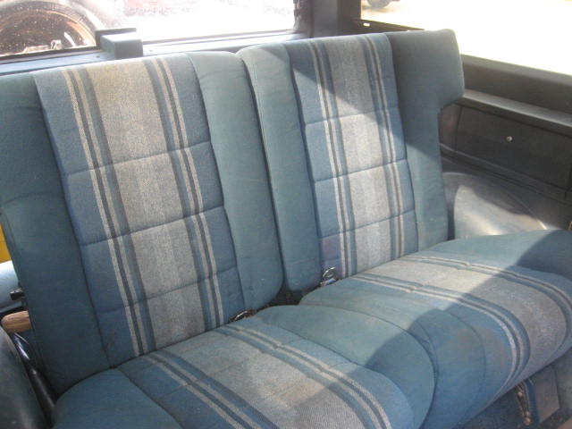

That looks a lot like the standard equipment fold down bench there duce.
I didn't realize rear buckets were rare, I also learned that the pine tree pattern seats were eddie bauer...there is a set in my local yard.
Actual rear buckets ("captains seats") are rare in the Bronco II. What Duce posted is a standard equipment fold-flat rear bench.
