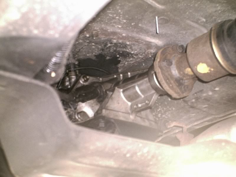

7. Real 2wd trans without dummy case in 2wd models-Yes and no. later model ones are rumored to have a ranger 2wd trans. AllanD would be able to confirm this.
seen this, I even have one of the "adapters" that slip into the back of a Mazda trans with a four bolt flange for the bolt on driveshaft.
What is "rumor" on this subject is an A4LD (or FM132) equipped bronco2 with a similar "adapter" and no dummy T-case. If anyone ever sees one of these I want that adapter! (I have plans for a Dana TC28 T-case)
Brian's 1990 had that..
