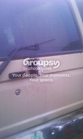

This cost me a dollar for the metal, 20 cents for the nuts and bolts.
Sandwiching would probably be better,but this has held up

pics from 5.0fox
There are 2 different styles too as you can see from country's pic and the one 4.0 posted. If you have the 2 bolt one, I'd find a 3 bolt one. Thats what I have and haven't had any problems keeping a 35" spare on it.
