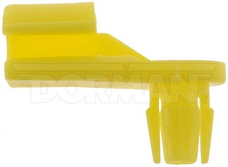

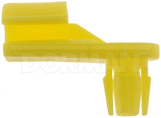

@wildbill23c On my '84 Ranger the tailgate release rods were held onto the latch arms by the plastic pieces. I tried these:
36671
(Dorman 75451) which were the closest aftermarket replacements for this type that I could find, but these are listed for later model Fords, They didn't hold up at all; the arm thickness or hole size may be different on earlier models.

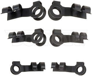

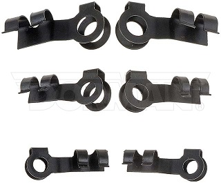

Here is what I end up using instead on my Ranger (and these are holding up well), which are metal throttle rod clips:
36673
Most parts stores carry these clips individually, but the Dorman 41016 pack has three sizes, and includes one each in LH and RH. I cut thin slices of plastic tubing to make bushings for the rod ends (fills the gap in the arm holes where the original clips' "fingers" were), and I squeezed the new clip retainer tabs so it clipped onto the rods real tight. I think I used 4mm pneumatic tubing to make the bushings; simple slice with a razor knife, the thickness of the arm, and they worked perfectly.

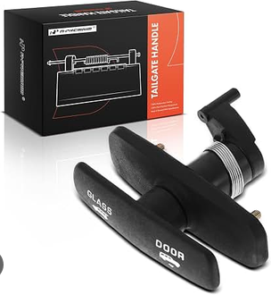

I'm hoping the original parts that the latch rods are connected to will connect to the explorer handle, I only grabbed the handle mechanism, couldn't get the rods out of the rest of the mechanism at the pick a part, no worries plenty of them over there if I have to return to grab more parts LOL.

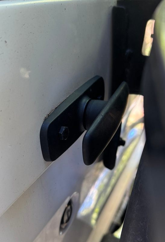

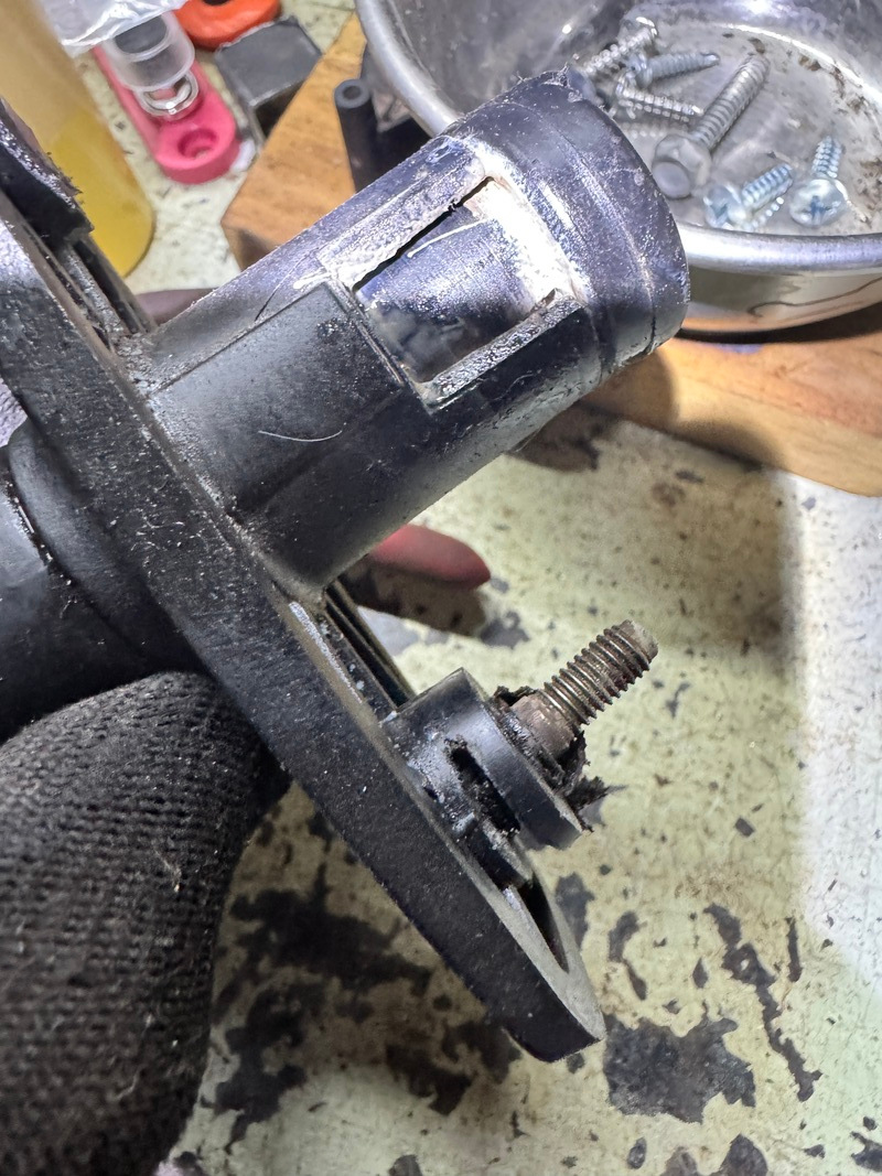

Didn't feel right drilling out my bronco II hatch to accommodate the explorer handle.
So I removed the explorer studs, and drilled 2 small holes (through the plastic explorer base-plate).
Yes, you can see the bolt heads...but some nice button heads would almost look OEM.
Also, my fiberglass hatch wasn't harmed during the installation.
Win, Win :)
