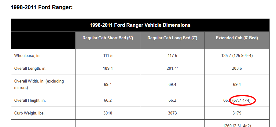

I'm guessing you have done the math to death, but in case you were just spitballing (and I was interested given the 2007 is the same per the dimensions page)...
the dimensions page says 4x4 ('98-11) are 67.7" at the highest point, stock tires vary but say the 27.4" (225/70R15) I have seen on a few... that's 5.6" difference, half of which adds height and half goes above the axle right... so 2.8", plus your 5" lift kit... on paper total height of 7.8" on top of the 67.7".. looking at 75.5" - a fair shade over 6'.
Course the tire sidewall squish will be different and you will probably not see every last bit of that in reality, but was that numbers you were seeing too?
