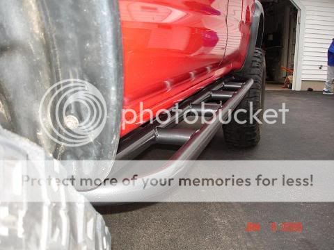

Exocage, but same principle on the sliders.
-Jester
I like em!
I'm going to be re-vamping mine here pretty soon, and I think I am going to copy you. :D
Its nice having a little step for cab/bed access and they should protect the rockers just fine
4x2" 3/16th box. 2x2 3/16th box legs.

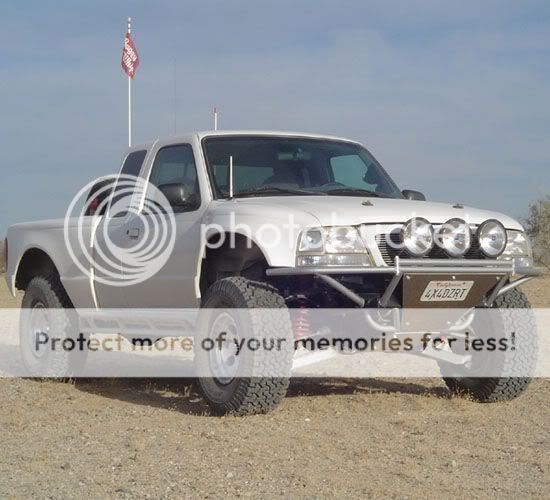

Not on yet but this is what they will look like. I cut the stock rockers out which is why the body looks funny.
I kinda like the truck with out the rockers. If anything major ever happens to mine I will remove the rockes and build some heavy duty sliders.
