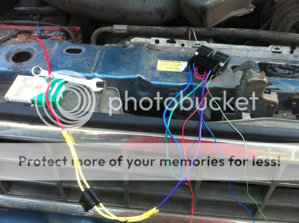

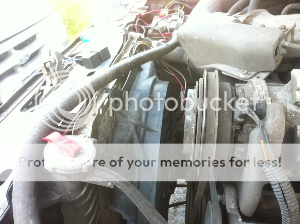

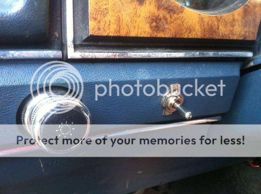

My electric fan upgrade. Fan is from a 95 ford Taurus 3.8L v6 it's a 2 speed hi&lo fan I have Made a harness strong enough to support the fan in both speeds 1 relay for hi and 1 for low and I have a 3 position switch. It's hooked up and tested out Awsome! My 2.9 runs at 180 on low and 160 on high and I have more power now. I highly recommend doing this regardless of engine size.

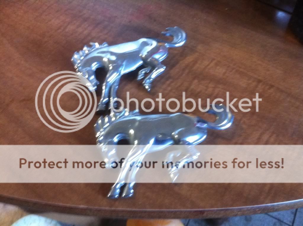

And I found these in a junkyard today!

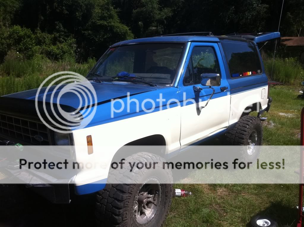

I like that b2 and i wouldnt mind havin that tire/wheel combo.
id like the wheels better if they were offset diffrently. more twards the out not tucked in. i want some steel wheels now, and to top it off i have an eletrical issue now, i have no power inside it

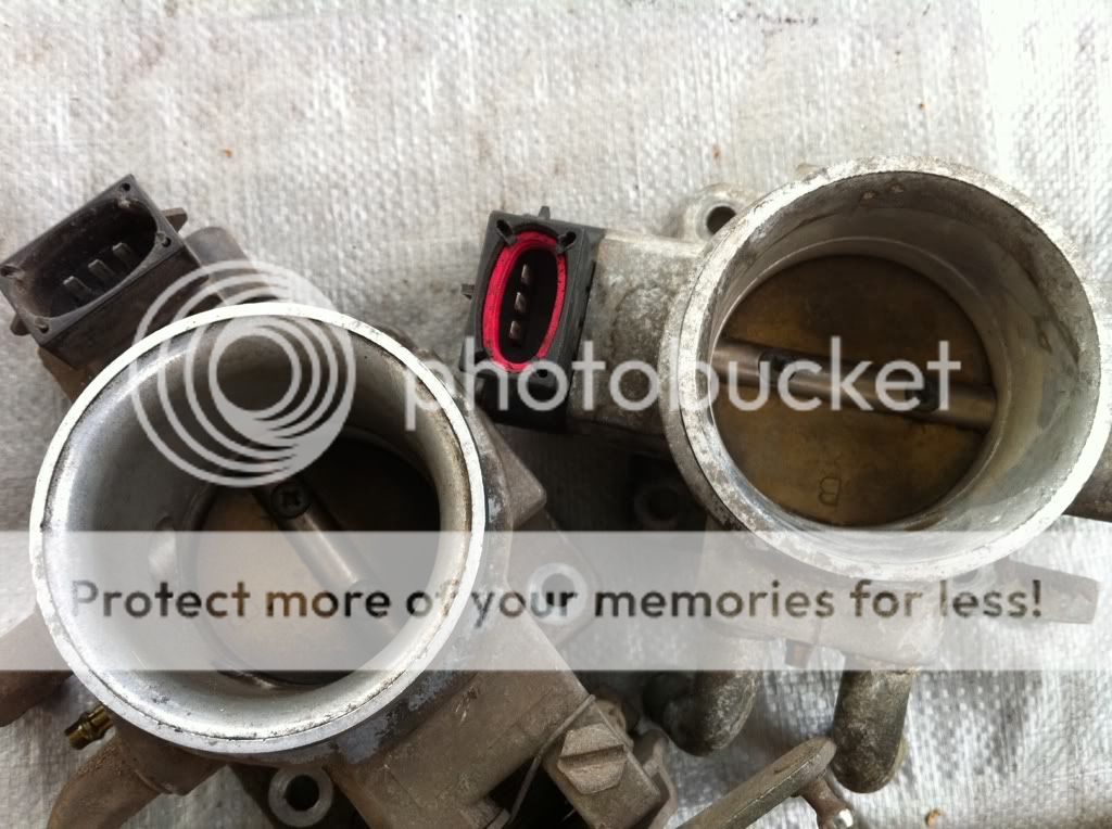

also a little update: i got a throttle body from an 86 2.9L ranger its way bigger diamiter than my 88's ill be installing it after i get er goin again. keep an eye out!
So. I got er fixed and goin again!!! Little yellow bugger that I have no clue what it is but I got it fixed... Also I installed the throttle body.

Nice looking rigs you got there...i like the blue white combo.
ya i have wanted to do that to mine for a while but at least around where i live there are already a few rigs that are od green, and my brown and black stand out a bit LOL.
Not saying OD is bad it look freaking sweet!
