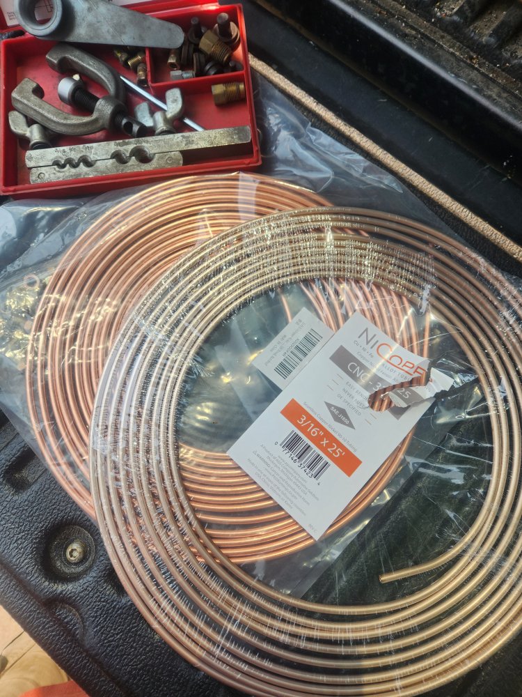

I forgot to add...
NiCopp is no different then the rest of the auto parts these days. Often imitated... rarely duplicated.
I ordered a 25 foot roll on Amazon... it just didn't look right to me. I dug in and it's pretty much a copper... despite the listing that is misleading.
I ended up sourcing true NiCopp from the local parts store. I simply didn't trust the Amazon purchase. You can visually see the difference below. True NiCopp has a much higher nickel content... but it is roughly 2x the price.
Hmmmnnn. I just looked at Autozone.
AGS NiCopp 3/16in x 25ft Nickel-Copper Brake Line Tubing Coil
$66.00.
Even with the increase in price, I would still go with the brand name stuff from AZ. The stuff from eBay comes with the fittings though.
