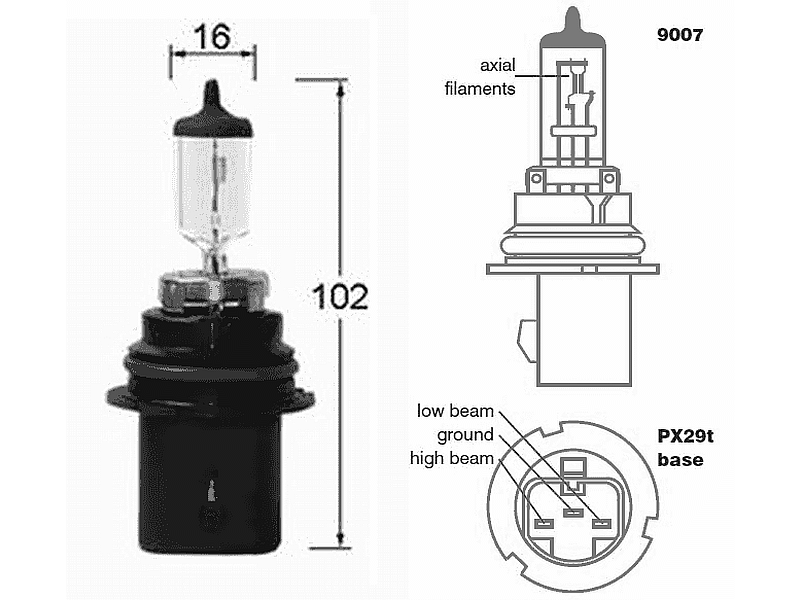

Not sure what your 2003 stock Lamps are, but on my 2001 replaced HeadLamps & FogLamps as listed below;
running 8years+ now in stock Fixtures with results that are not overly bright but a definite improvement over FactoryOE:
HeadLamps
~ FactoryOE = 9007hb5Base 065wHi 55wLo Yelo 2FilamentBulb Sylvania\Equal
~ Replaced by 9007hb5Base 100wHi 80wLo Blue 2FilamentBulb Sylvania\Equal
