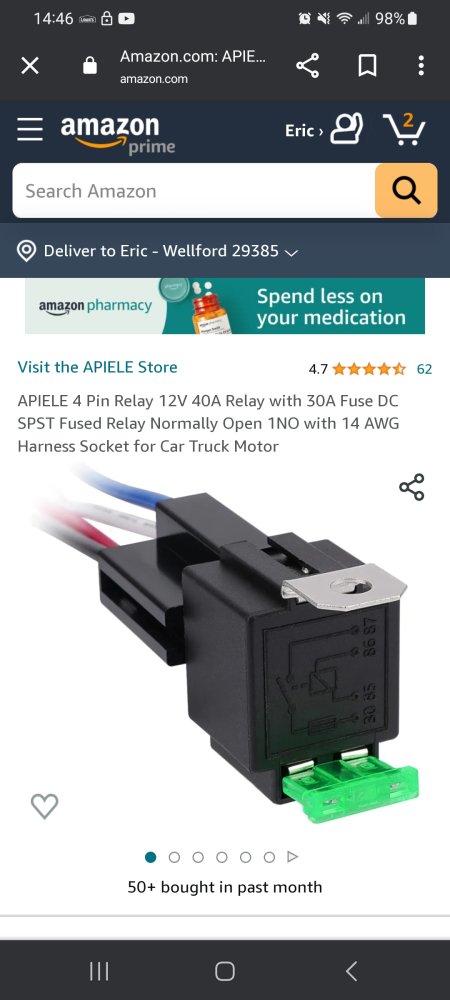

I've tried it on my 93. The extra spaces in my fuse/relay box didn't have wiring connections in them and I had trouble finding the right connectors to fit and lock in. So, in my experience, its easier to install the new fuse and relay separately. Newer trucks may be a different story. But, you can buy the relay and relay base with fuse holder built in very inexpensively and just tie it into a keyed power source that can handle the current (120watts = 10amps). Then run your circuit.
mixed results with those.
Cool. I haven't used them myself, though I ordered a few a while back and have them in my parts inventory. But they look handy for his application. I normally install separate fuses and relays.
