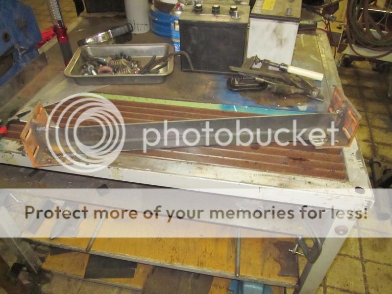

I built some new mounts for my rear shackle frame mounts trying to bring the springs back to their original position. I didn't want to re-arc;
I ended up going to the lowest holes and have run one race so far with no indications of problems. I think as long as you brace well and from one side to the other there shouldn't be any problems. Of course that depends on your fab skills, and if you are driving this on the road make sure the fab is good....it's not just your life at stake!
