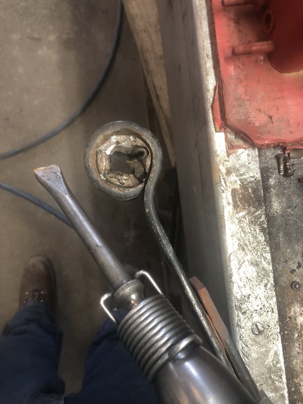

I'll start this by saying that it didn't work for me (lol)... And it'll only work on leafs who's eyes are wound back onto themselves just right.. anyways.. just learned about this "trick" the other day and it kinda blew my mind..
Instead of torches or hole saws or drilling a billion holes through the bushing or any of the other PITA methods for leaf bushing removal.. all you need is an air hammer accompanied by a chisel bit and a flat hammer bit.
Starting with the chisel bit.. chuck it up and drive it into the pictured gap. This will spread the eye open slightly AND keep a hang on the chisel bit so you can slide the air hammer off of it.. put the air hammer bit IN the air hammer.. and then wail on the inner sleeve driving the bushing out of the other side.
As I said.. didn't work for me. I chiseled the eye open a measurable amount easy enough, but no matter how hard I leaned into the thing I couldn't get it to hammer out the backside. The outer sleeve must be hopelessly siezed to the leaf.. I'll have to recruit my buddy again for some torch work.

Did you wedge the chisel bit in the same direction as the arrow? That would tend to make it tighter even with a gap.
I’ve had leaf springs break at the eye because of rust on the bushing sleeve and the leaf spring forcing that apart where they are telling you to use a chisel to spread it so I’d be skeptical there…

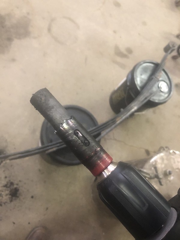

Best I came up with was hole saw the guts, sawzall a slot in the outer shell and then wad that up with a hammer and chisel (eventually culminating with an air chisel) until it falls out. Repeat 3 more times, good for hours of entertainment! :icon_thumby:
Well.. mostly in that direction but kinda at a 45° angle.. didn't want the chisel to end up hitting the sleeve cause that would just have it stuck in there itself lol. It definitely opened the eye up.. but yeah no bueno when hammering on it.

Breaking the eye was definitely a thought in my head because I've seen leafs break in exactly that way.. calculated the risk and decided to take it anyways lol.

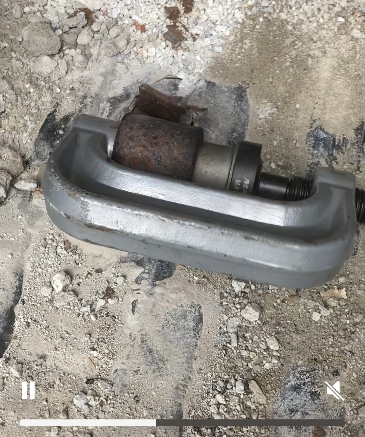

Best way I’ve found for removing and installing rubber bushings with metal sleeves is a ball joint press. I’ve never tried a hydraulic press, but I image it would be a paint to use without a few people to help hold the spring.

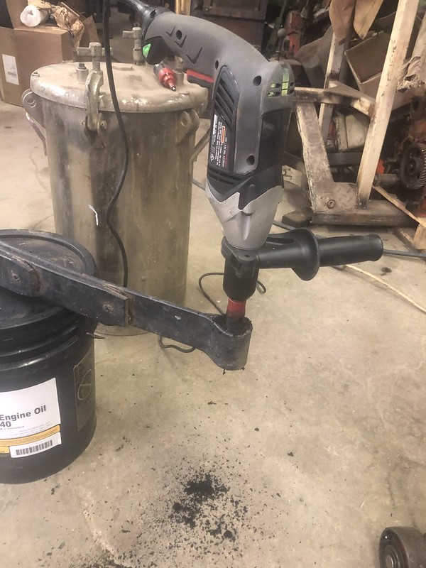

Start a small fire in your fire pit. Set the spring down so the bushing you want to remove is in the fire. After a few minutes, remove from fire and push the remaining burnt rubber like substance out. (Do not do this over your nice paver patio, your wife will murder you.)
