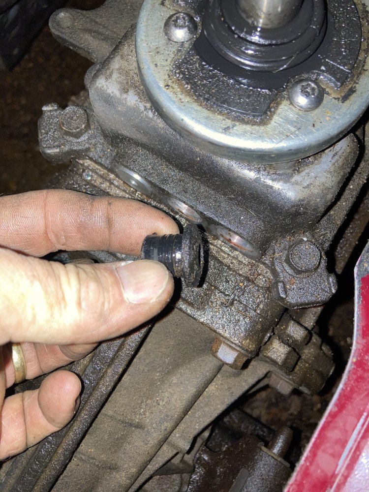

So I have delayed addressing a leak on Frankentruck, the triple rubber shift rod seals on the transmission top plate for the M5R1 trans. I have been avoiding driving long haul so I don’t deplete a second fill of oil. Bleeds pretty good when topped off for sure!
Today I did a fuel pump hanger so my fuel gauge would behave at all temps (old/tired) and had the bed off. Figured I’d tackle the transmission leak as well.

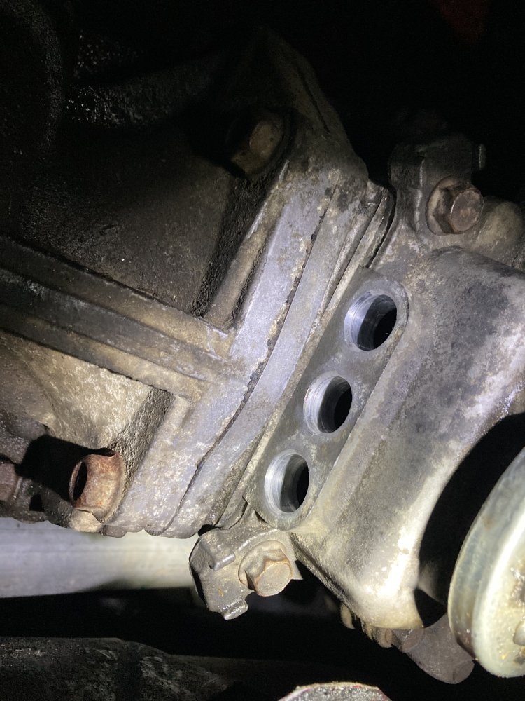

I didn’t have a solution planned and I wanted to verify that it indeed was the three seals on the top plate.
Once I viewed the situation, it became obvious that I wanted a proper repair and one I could trust, service, reuse.
The bores are about .628 in diameter, I only have pin gauges to .501 so that was close enough. The bore is about .500 deep. It has a chamfer at the entrance.

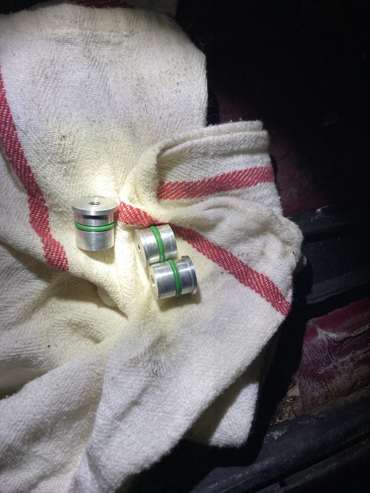

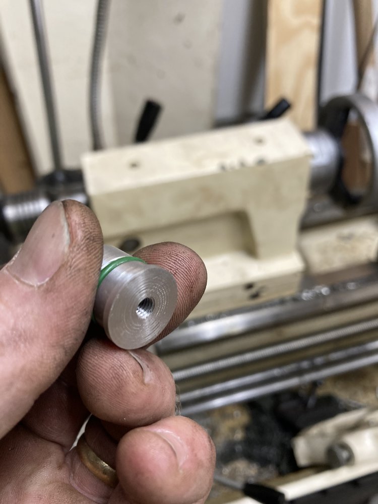

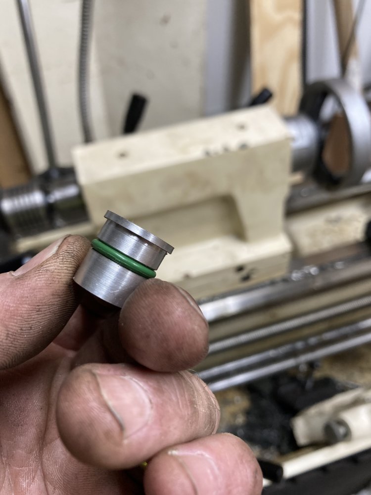

I turned a plug from 6061 to .625, added a simple o-ring groove to an OD uncompressed of .630. That ring rides about half into the bore so there is trans case meat to both sides. There is a .700 diameter flange on the plug. For extraction and seal breaker, I d/t a 10/32 stainless cap screw into it.
I had some AC system o-rings handy and just used them, 12mmx 2mm

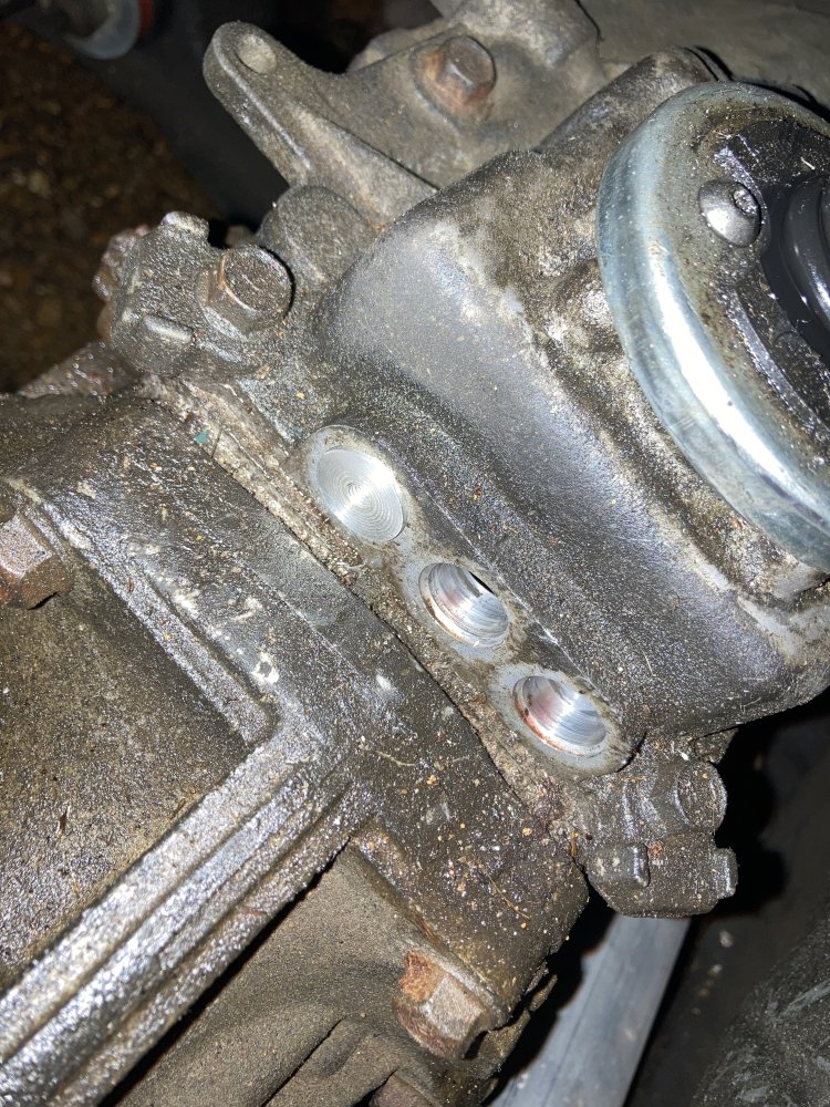

The middle plug has a caveat. The tail shaft to main case rib is tall enough to prevent a direct entrance of a rigid plug. So I shortened that plug to .500, thinned the flange and removed the flange on one side so that it would just barely make it over the case seam and go straight in. Once seated, the section with flange removed was clocked to 12 o’clock so that gravity isn’t going to allow oil past it.
Ultimately the o-ring plug snaps in quite tightly. The plug is coated with black permatex silicone and the middle plug is rotated as mentioned. The ring is a seal in and of itself, it’s also keeping silicone trapped on both sides of the ring so there won’t be any oil passing the plug even if it developed modest pressure.
The 10-32 screws are sealed with blue something, a gasket treatment. They are driven in finger tight. The middle plug is turned 180 degrees using it and an Allen wrench to keep the relief cut on top as mentioned before.
For service, put a good Allen wrench in head, turn as to tighten screw, this will break the silicone seal and also allow extraction.

Rubber does rubber things, fall apart and the trans spits oil out the holes and bleeds to death.

Update: I tested the silicone and plug seating 12 hours in. I wasn’t happy with the 10-32 sealant, it hadn’t set yet. I had never used that sealant which was for gaskets. But the plugs are definitely only coming out if you intend them to. I mean they are really really tight and well seated.

With only .003-.005 clearance on the plug and the o-ring slightly compressed, there is zero chance of the plug leaking, ever. Ford should have done this. The silicone film before and after the o-ring make 3 separate seals for oily to get past.
