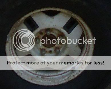

What about the white steel ones that look like this.
6" wide, 235/75-15 is about the limit if you go with the recomendation charts. I doubt the base gray wheels the OP has are any wider.
