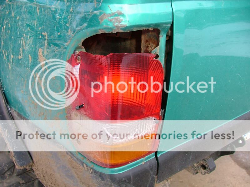

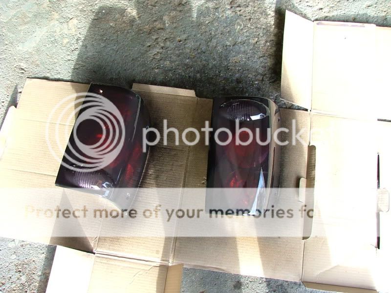

Swapped out my tail lights today for some euros I had laying around. I used them before but the always fogged up and looked like ass so I decided to tint them, maybe they will look better if you can't see the ass.

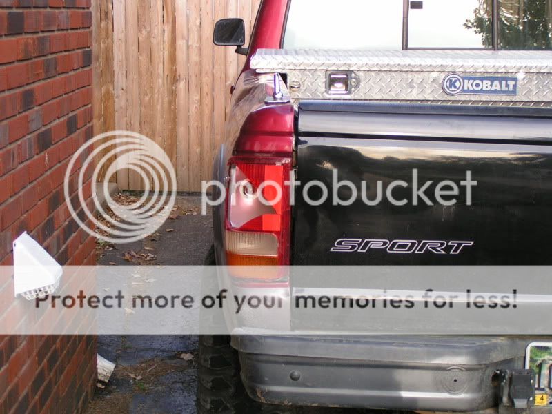

So here are my original tails, then see my temp fix to get home. Zip ties FTW
Kyle M's Ranger Rebuild
and their replacements

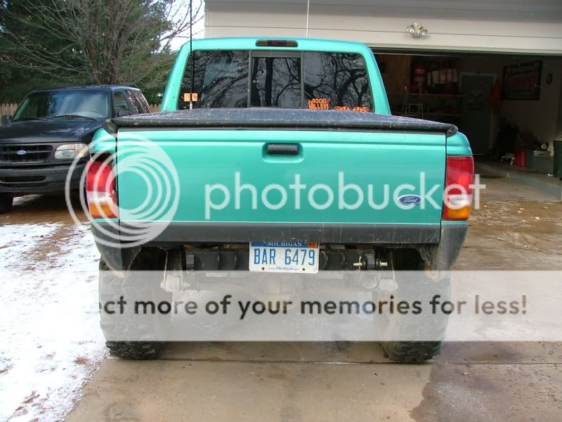

a little dry time, and now installed, pure pimp

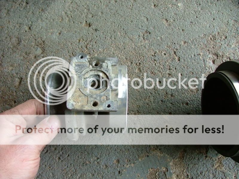

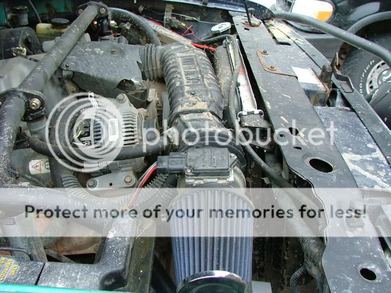

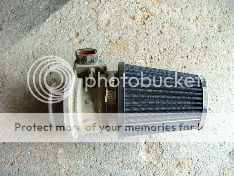

And I also had another problem yesterday, I have(had) a super ghetto fabed CAI on my truck to miss my shock hoop. Any way, I epoxied a cone filter to the MAF and it worked fine until yesterday when sometime the filter fell off. My truck started idling funny wet and took a look and the filter was gone.
SO I dug up the other filter I had and decided to make it attach to my MAF a little less ghetto, here is how I did it.

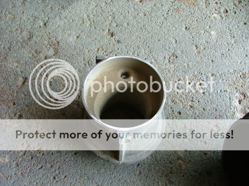

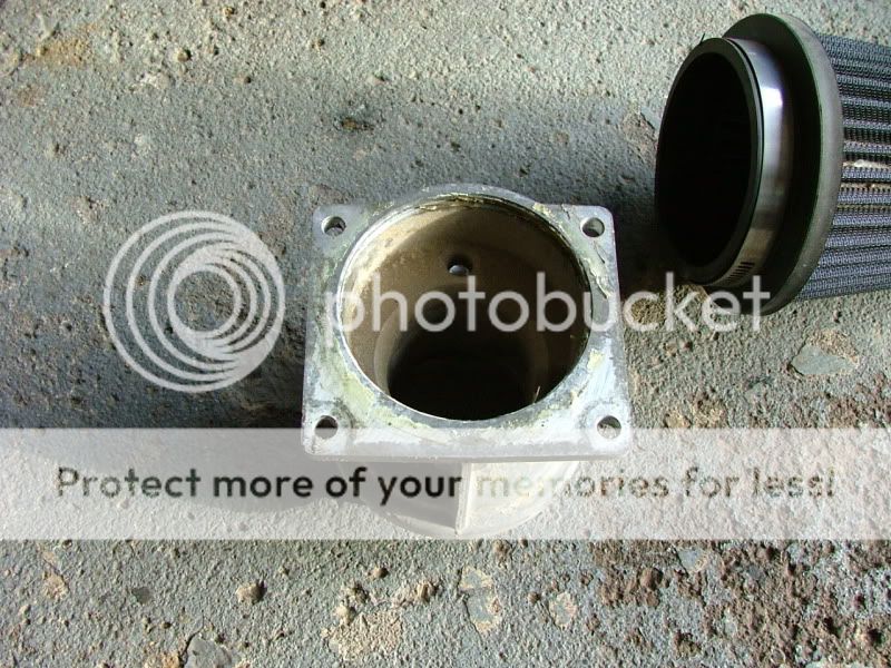

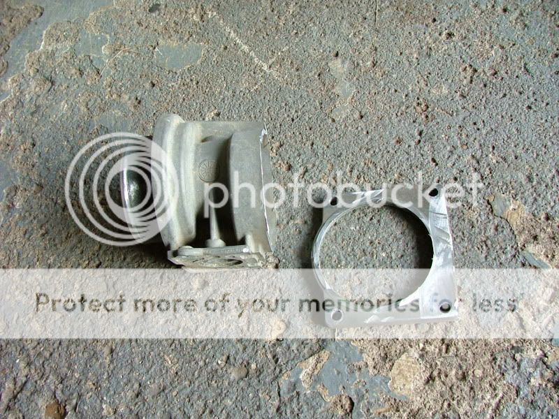

I decided to cut the flange off the MAF, it looked like that if I took that off the filter could clamp right to it. So out came the cutting wheel and I went to town

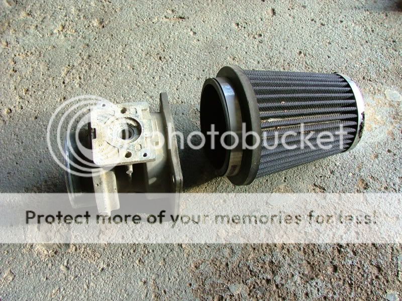

then I cleaned it up a little
Filter mounted

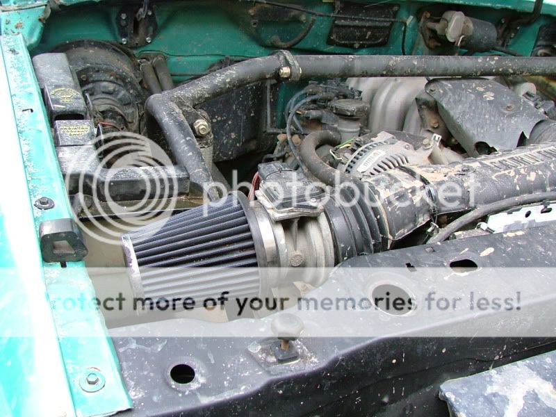

mounted on the truck, finished
I am happy with it, took me 5 min to do and cost me nothing.
might wanna do some form of snorkel, unless you guys dont have deep water over there
Yeah, this is still just a temp set up. I plan on getting a newer 4.0 air box that locates it where I put mine, then I will have an enclosed element I will add a snorkle of some sort to.
You know autozone has adapters for that.
Alright smart ass......this was free.

i give those new tail lights 9 and a half days before they disintergrate from the trees/brush!
Maybe time to invest in some of those metal tail light guards?
and you guys think you have body damage?
