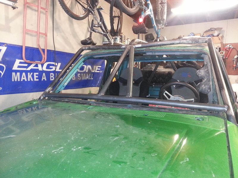

Got my cage work done, new windshield area, now that I don't have glass in it, I'm able to make it look not so stupid, I'm happy with how it came out

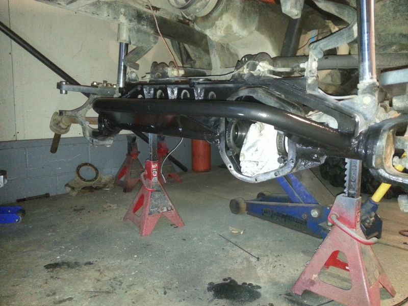

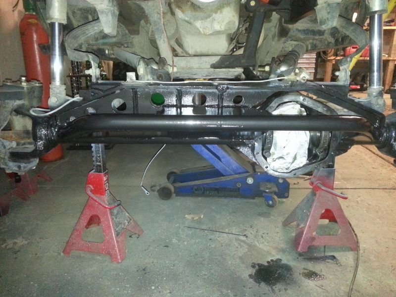

Also got my ram mount, front truss made.. Should work nice.

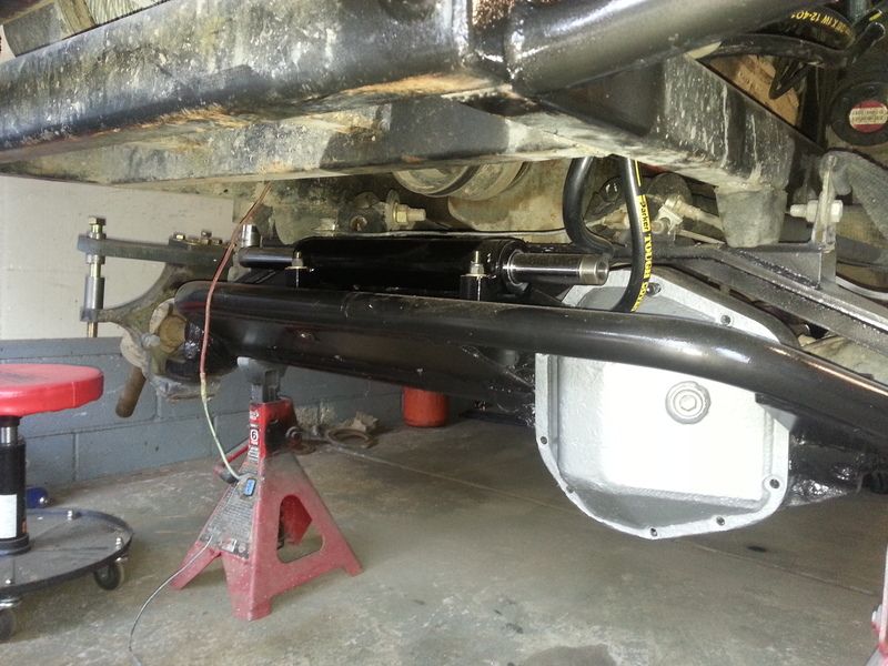

Here it is with the ram mounted
Just gotta tie up the new hoses somehow.
Made a set of ram heim mounts also

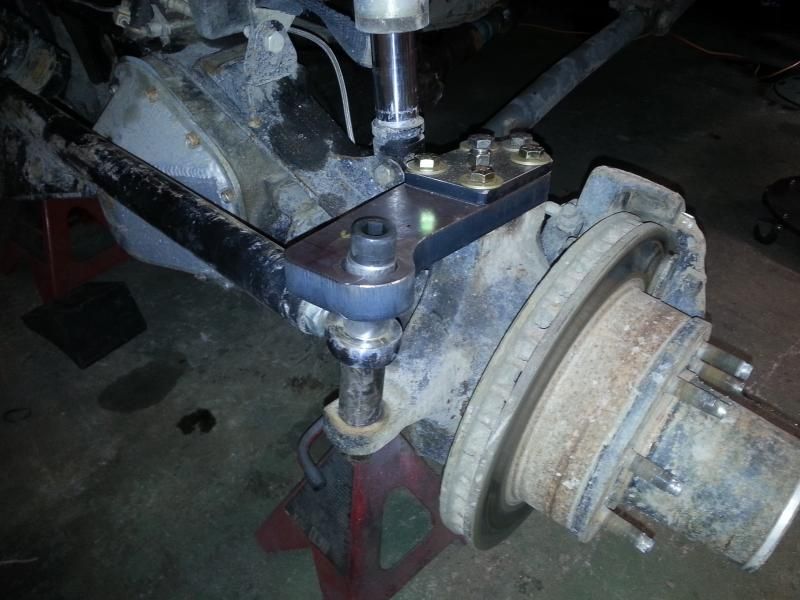

Not sure I posted this, but I made a set of high steer arms also. They utilize the factory tie rod mount so it's in double shear the bolts will be replaced with studs.
