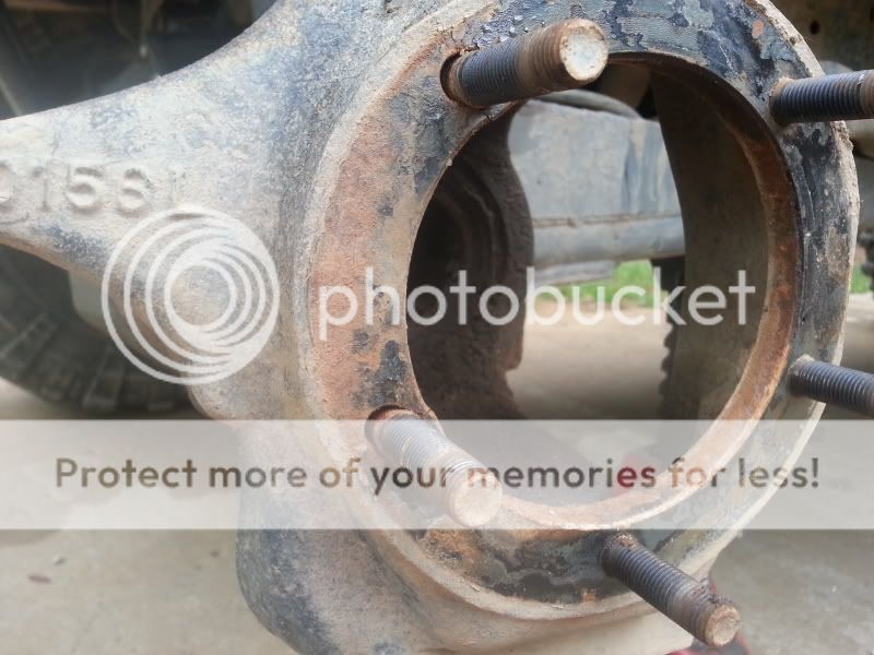

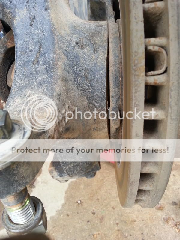

I guess I did alright building it lol. I don't see any other damage besides this...

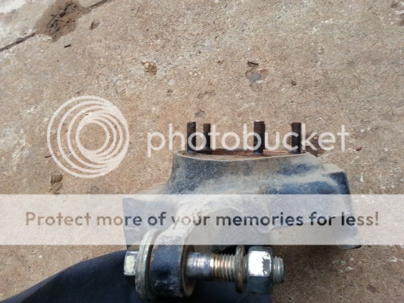

Looks pretty bent, at the tie rod mount is is about 1/2" further in than the passenger side. Who's got a spare for me?? It's an 87, 60 incase some does have one theywanna sell.
Not sure what I'm gonna do....

Fixed for now

I guess I should clarify that a little more. I had cracked a stock ford knuckle about 65% of the way around the thinner section near the upper king pin. I didn't catch that I had cracked it and proceeded to drive it 2 hours home on the highway.
Thankfully it held together for the trip, but that could have wound up going very badly if it would have let go at 70 mph. So for the peace of mind, a new thicker part gave me the warm and fuzzies over doing gussets.
