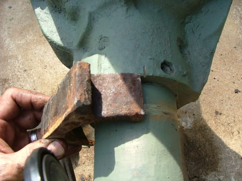

Did some hacking and wacking on my axles today. Cut and ground all my brackets off, shved the 14 bolt, it is now a 13 bolt, and cut the center section down on the 60 for room for the wedges. Happy with how it all turned out.
Pile of crap I cut off....
Axels all cleaned up and primered
The area I cut off for wedge clearance. It is about 1.5" or so
The shave on the 14 bolt. I still need to plate it up, but It will give me about 1.25 of clearance and no lip to catch on.
next on the list is to install gears, weld axle tubes, then plate the bottom of the 14 bolt.
Just wondering if you had to trim the wedges themselves to get them to fit? It looks like a tight fit.
You got a set or need a set? I have the wedges from my 60 available....
