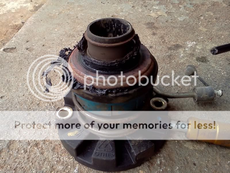

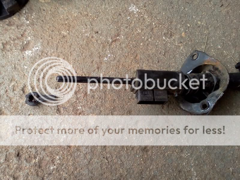

Anyway....I pulled the tranny to day to find a toasted slave. Gonna have to warranty that. Swapped in a new master slave cylinder for the one I broke too.
I tell ya, it was a pain to drop the tranny. Last time I had a body lift on and it cleared the exhaust no problem, this time it didn't. I had to unbolted the drivers side y pipe at the manifold and of course both bolts broke. Cutting them flush and drilling them out sucked. Got it all done and I should be ready to put it back together after I get the new slave.

I don't see anything wrong with the slave. Lol
