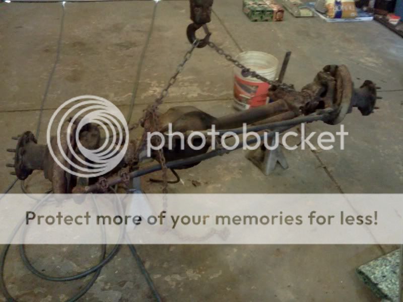

Picked up my 87, dulley 60 yesterday. Pretty happy with it. Now I just need to either sorce some wheels with the right offset or get some standard hubs to swap the dulley hubs.
Looks like I have a lot of work infornt of me....gearing/building 2 more axles, engine swap, bed dovetail, fuel cell.....I can't wait!

Well, tore the truck down today , I destroyed 2 more caps on the drivers side and my outer chromo on the passenger side is pretty messed up too. Ordered a new one, maybe I can get the old Yukon warranted? Good news, looks like my locker took the beating too so no need to do anything with that.
I think I am going to adjust my steering stops, looks like the joints are binding/hitting a little maybe that is the reason I am breaking caps everytime out.

Got my truck back together today, full chromoly front now with spicer 5-760x joints. I also tacked all the caps along with full circle clips. While putting it together I noticed my other good hub was broke too. So I put my drive flanges in, hope they hold, I'm out of spares LOL. So note to self, warn premium hub don't hold up too well for my set up, try something else next time. Lets go wheeling!
