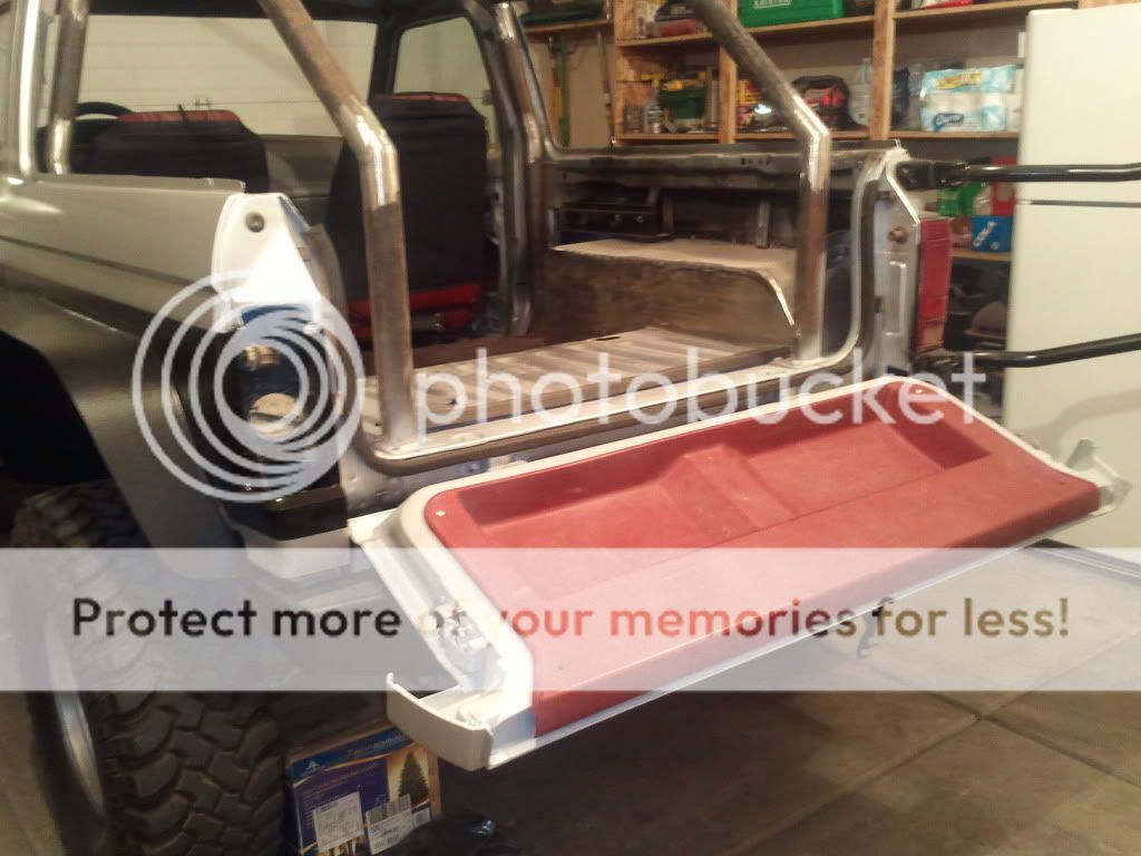

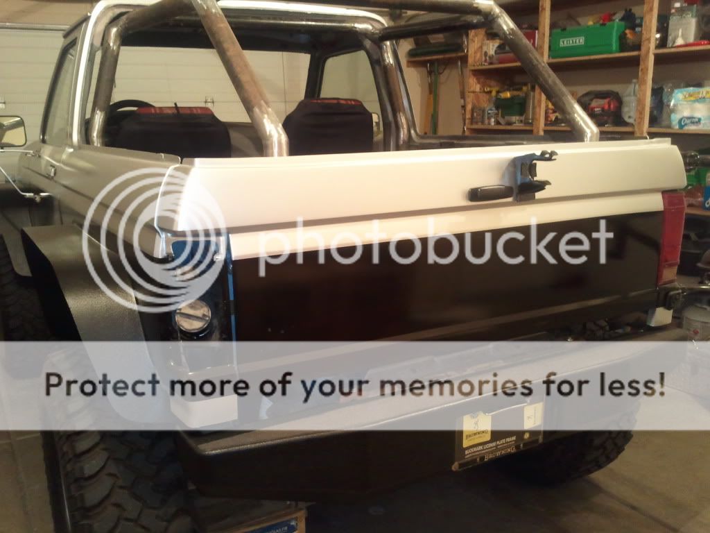

haha yeah! looks like tons of fabbing to get the gate to fit right. when the time comes it'll be an extended cab with a super short box set up the same as the mazda (toneau and toolbox.
Yea thats one of the few things I don't like about SUVs' but everything has there upsides and downsides
I'm kinda bummed that i cant do a recessed highlift! i dont the length to fit it anywhere
Make it fit on the inside somehow. That reminds me, I still need to get a highlift. But my v8 is first on the list now.

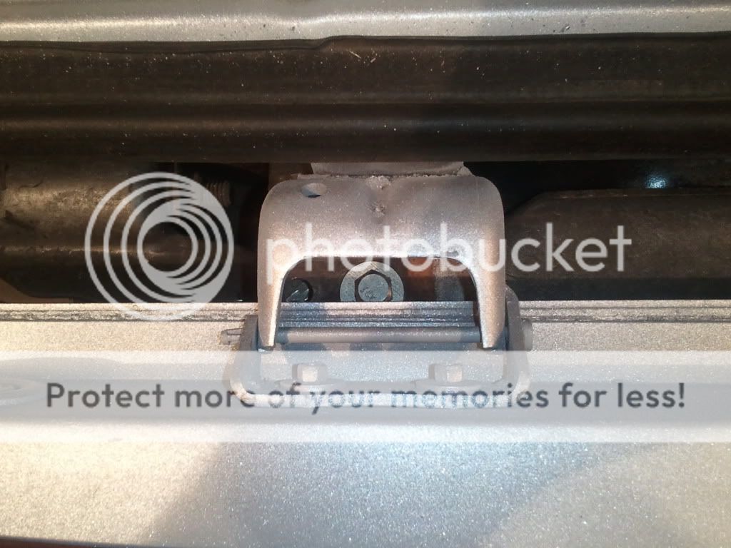

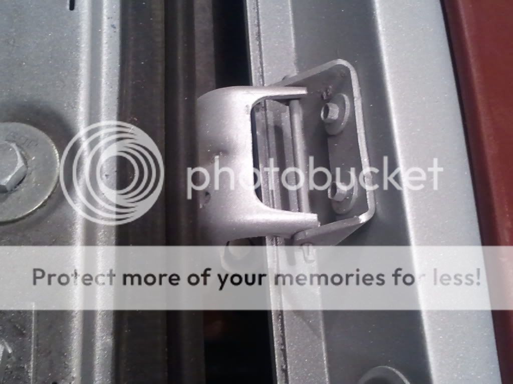

take your hinges off the top of your hatch and mount them to the bottom of the door and the body, idone it to my bronco so now it works like a truck tailgate and it was to easy.
when i done mine i attached them to bottom of the door first then hung the back on by the latch pins and welded the other half if the hinge to the body.
