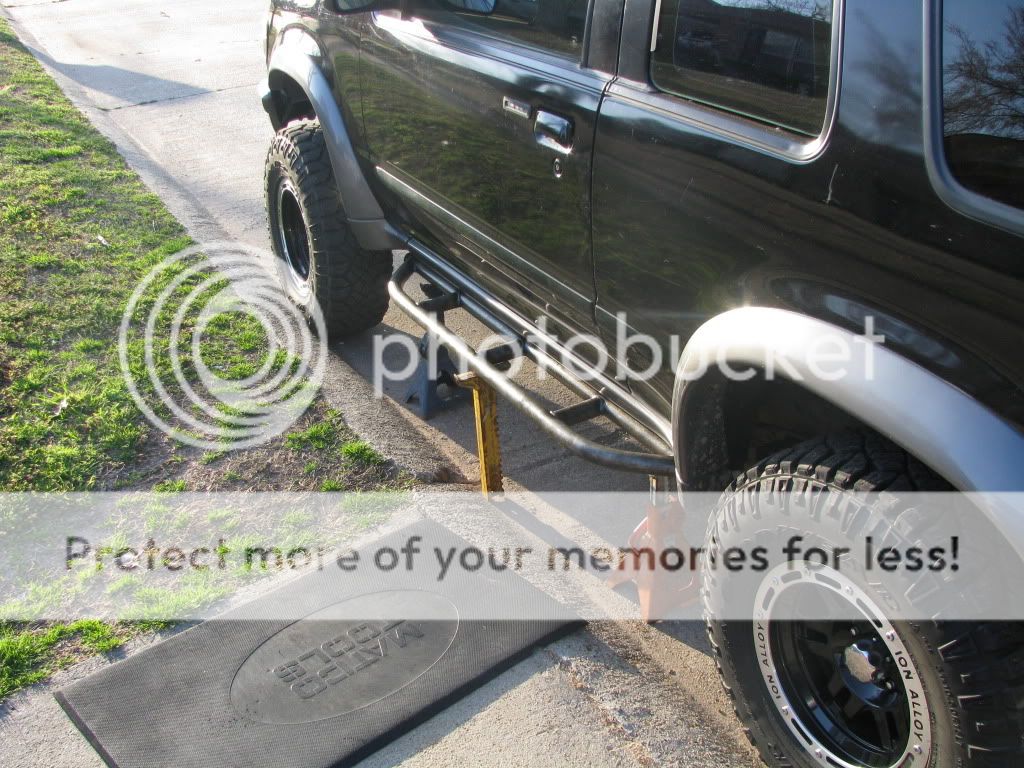

i also keep going back and forth between making my own sliders or just buying the trail gear one's. the price for their sliders and shipping is about the same price as building my own. if i build my own i could get just what i want but could waste some money on screwed up bends and what not. if i buy theirs i kinda settle for what they are and possiably add to them in the future IDK.
after even more reasearch i think i will most likely go with the TG sliders. i was concerned that they wouldnt stick out far enough to keep me off trees after all i'm not accustomed to much rocks. after seeing this picture i think they shall stick out plenty far.
now i just need to get another elusive commision check so i can actually order them
