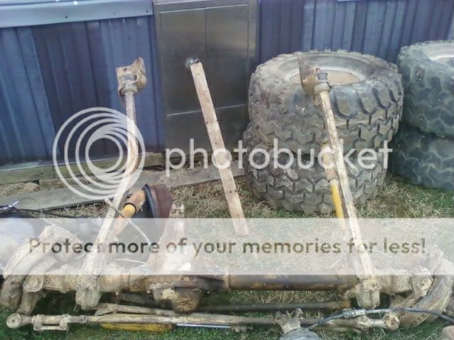

on another note, does this look ok? :D
haha
i dont see anything wrong with it.. lol if you need another radius arm pm me
its upside down i think. look at the radius arm brackets
EDIT: just looked again and the brackets seem to face different directions from each other so that doesnt help but its still the ford style c bushings which means i still think its upside down
its is upside down for sure, look at the shock mounts, and how the drag links are mounted, and the steering stablizer, and the calibers are on the back of the discs. of course its upside down!
yeah its upside down, but i was talking about the mangled radius arm. before i had it the truck was on a flatbed and they almost wrecked, but it was chained to the arm so it got pulled bad.

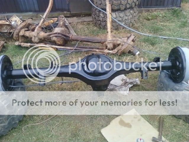

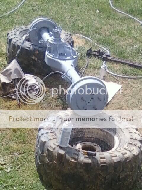

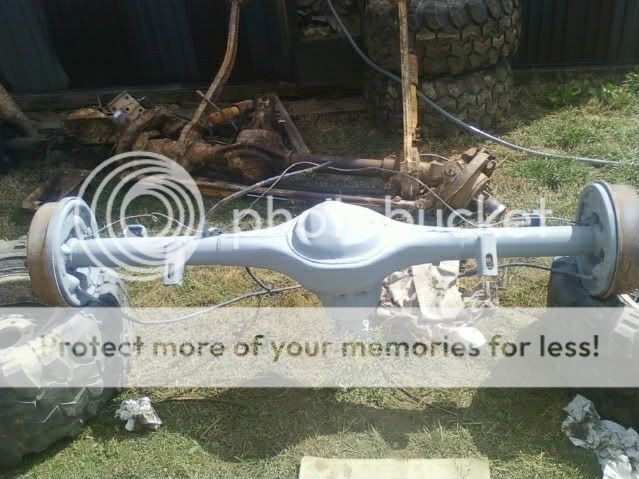

also the rear end is all cleaned up, about to primer and paint it. then ill start taking a wire brush to the front end. i wish i had access to some better tools for this kind of stuff! haha

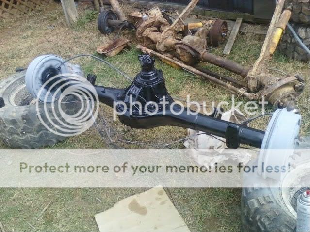

got the rear end geared and spooled. found out i must have a heavy duty 9" instead of a regular one. none of the carrier and pinion bearings would fit. had to look up the numbers and found out the size bearings are for the "heavy duty 31 spline non-posi ford 9" haha..

and a went up to 5.39. figure it should give some pep to that 2.3. i wanted 5.29 but they dont make them for a hp reverse cut d44 apparently..
