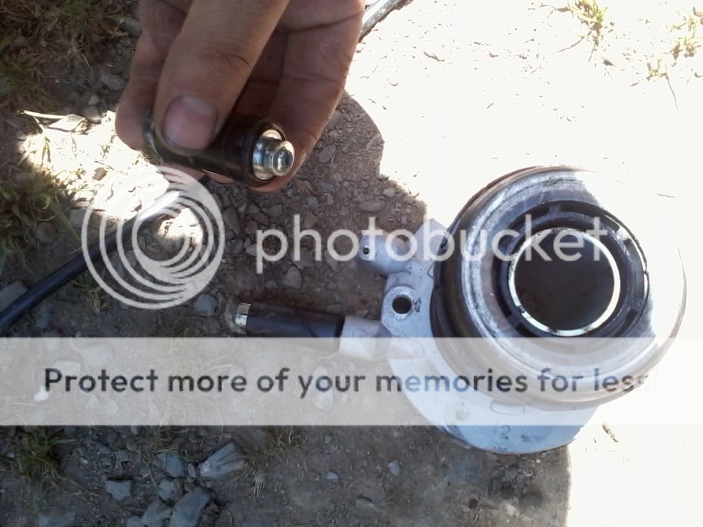

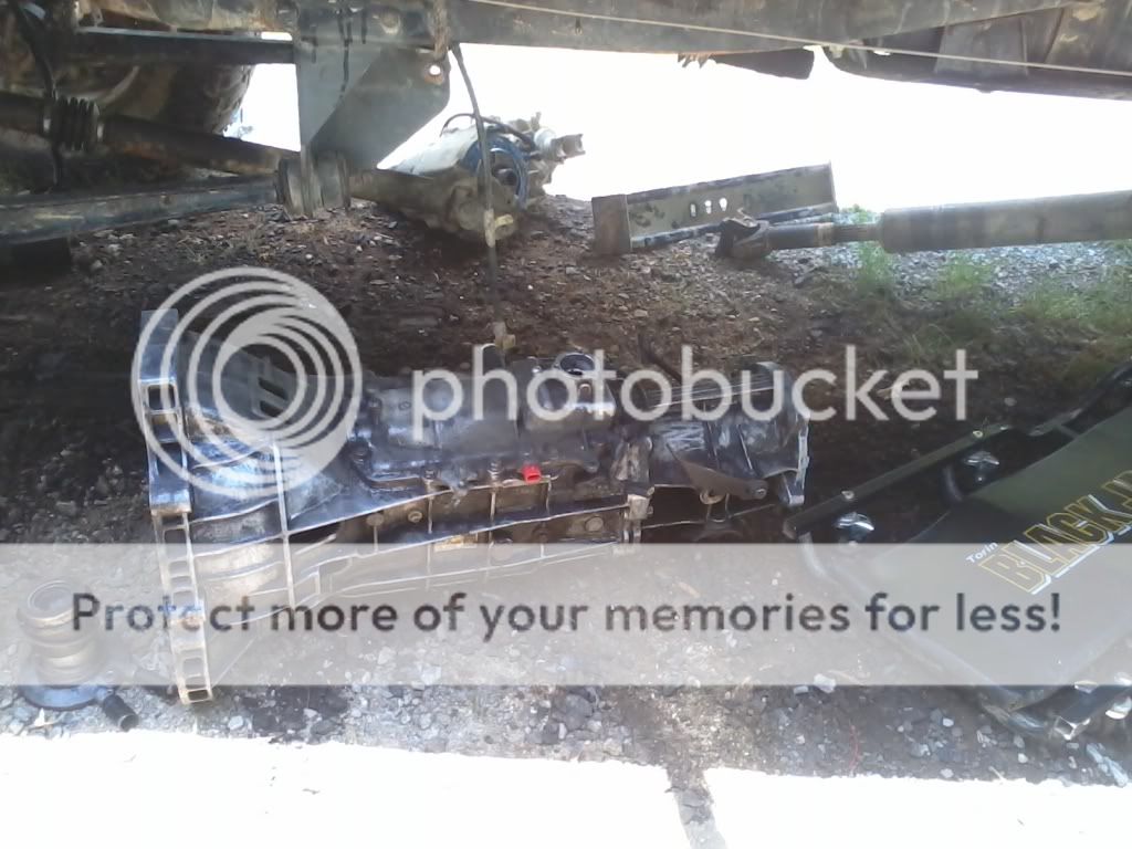

More bad luck. The disconnect sleeve was all bugered up and ended up breaking the slave fitting ... so I spent my evening pulling all my drivetrain back out. One step forward, 3 steps back

Drivetrain

The broken fitting

In other news I got my transmission, tcase, driveshafts, exhaust and master cylinder all in. Took me and 3 guys about 4 hrs along with screwing around a little. . That's with a gravel driveway, no air tools and no Jack (mines broken). Not to bad. Just piddly stuff tomorrow then I gotta pack for the lake on monday
