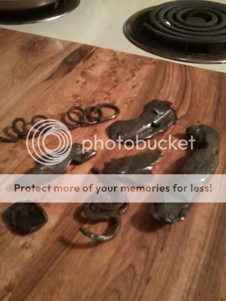

think i found why my brakes have been spongy. finally tore the rear drums off saturday and the passenger side had a spring pop loose, which caused it to grenade and basically destroy everything brake related on that side except a few parts.
this is what fell out when i removed the passenger drum.
