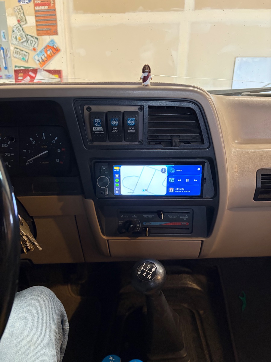

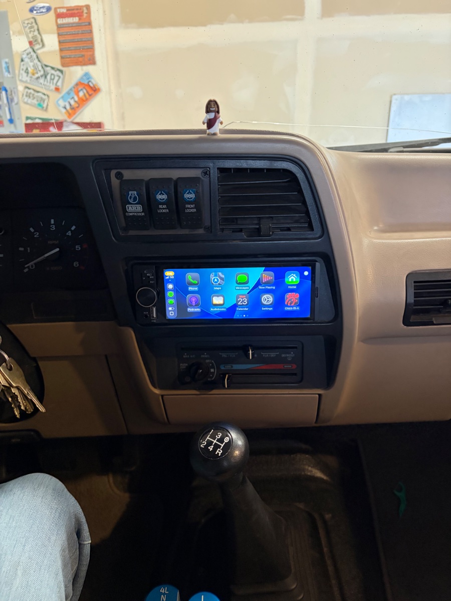

I didn’t realize that I didn’t put the final
setup pics on here. I have been driving it since November an I have it some miles on it- both off road and highway.

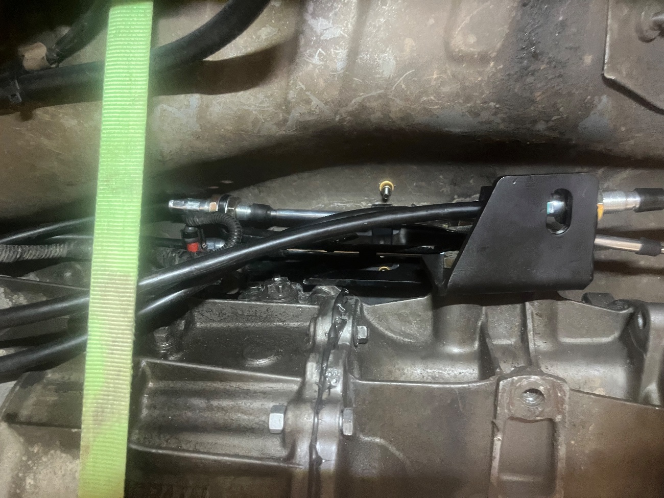

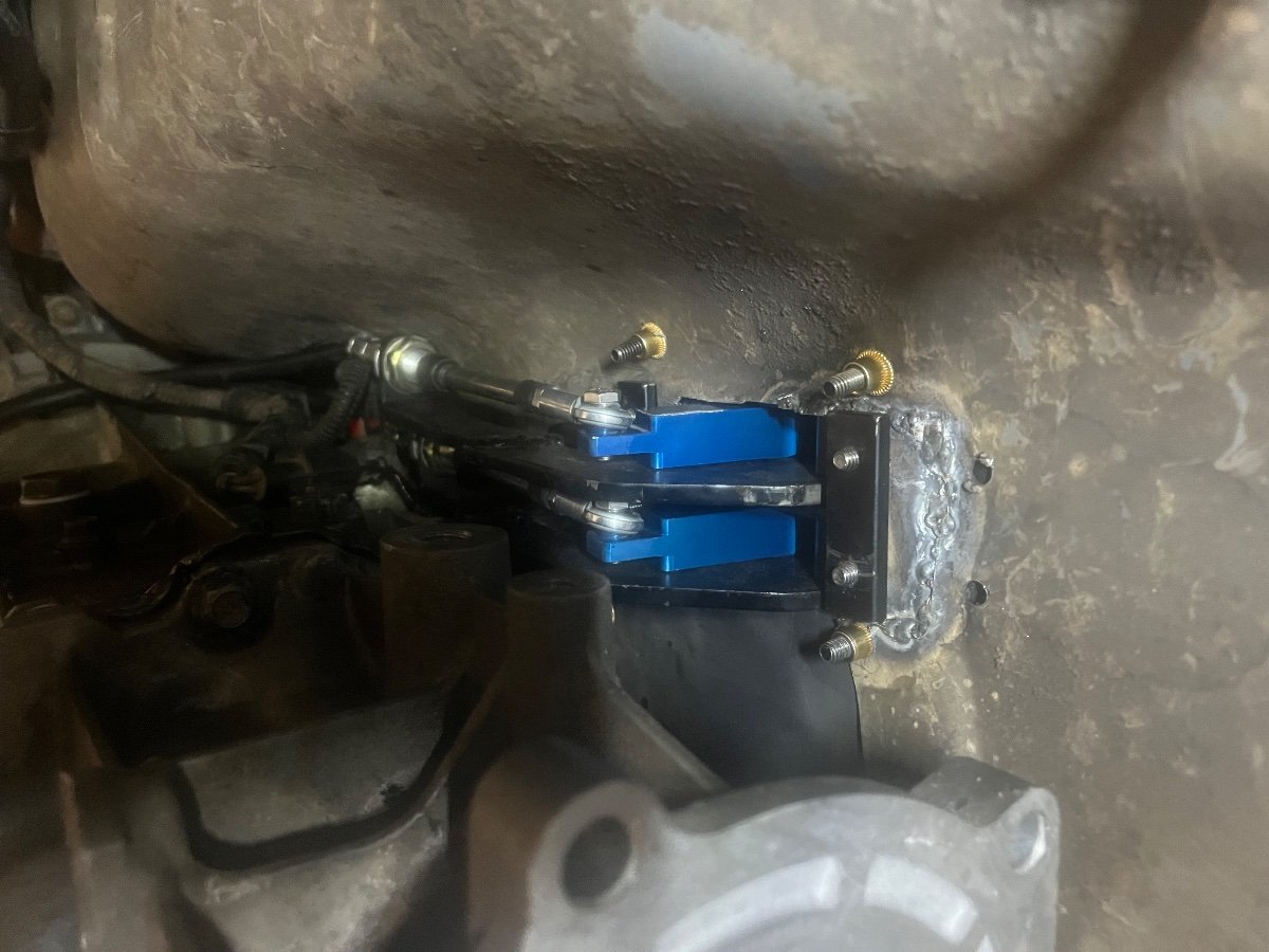

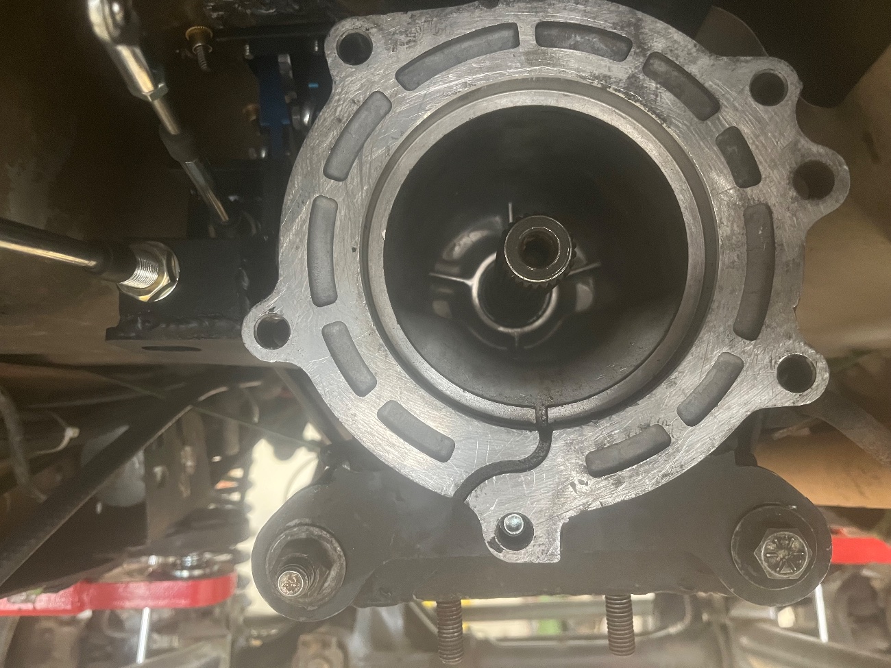

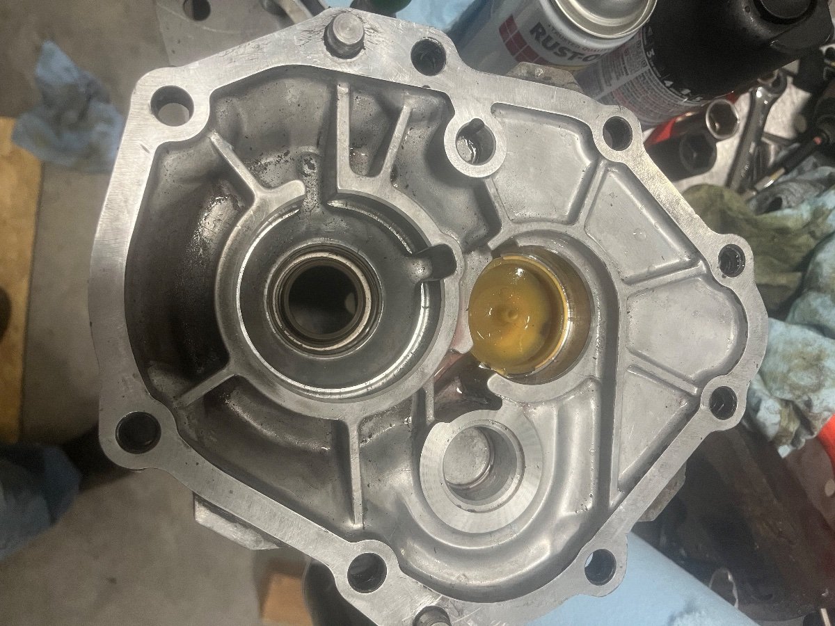

I got it all installed an the tail shaft seal of the transmission was leaking. So I had to completely remove the transfer case and replace that dumb seal.

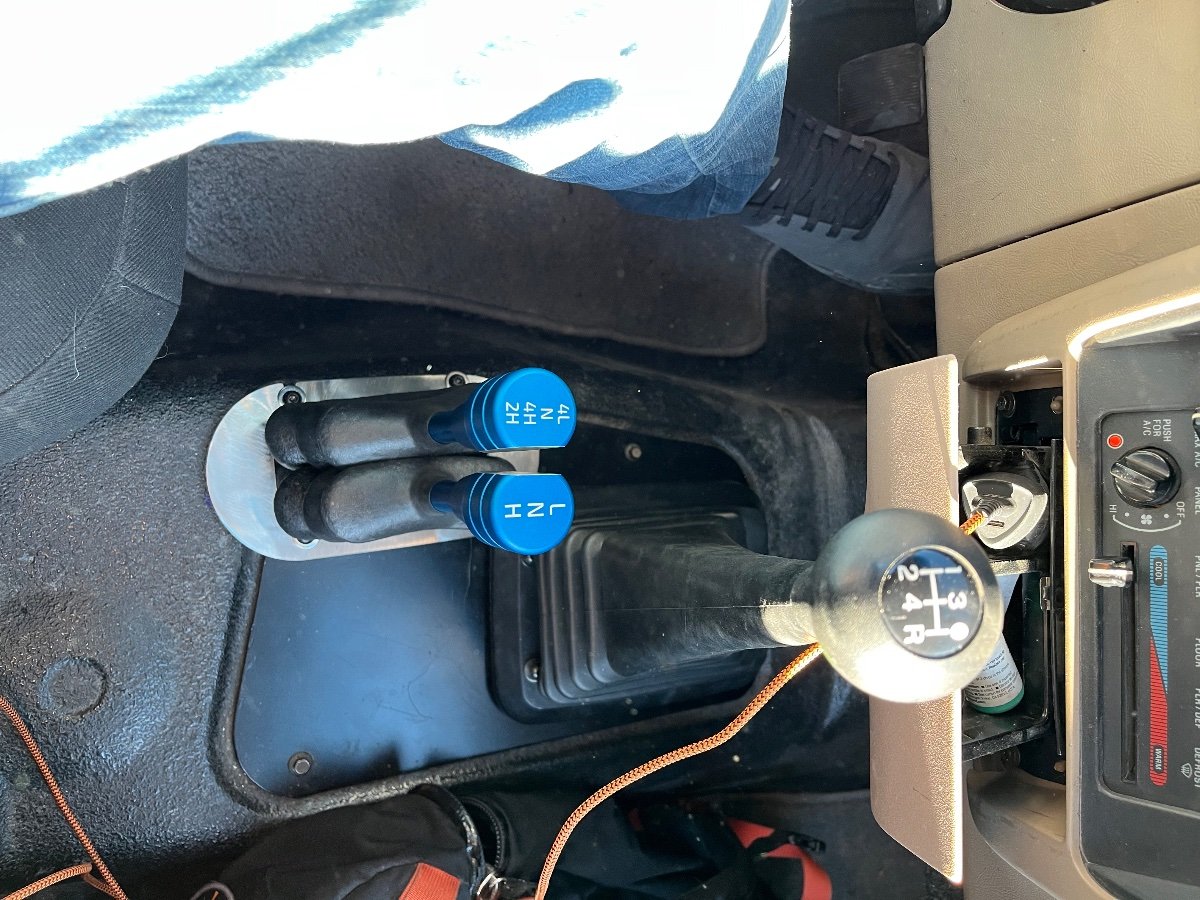

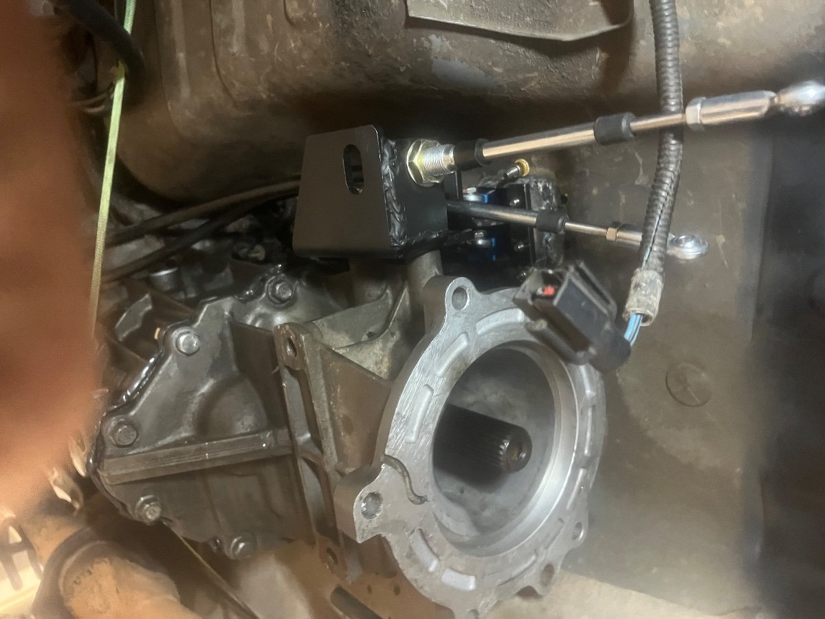

That gave me a chance to take pictures of how tight the shifters are:

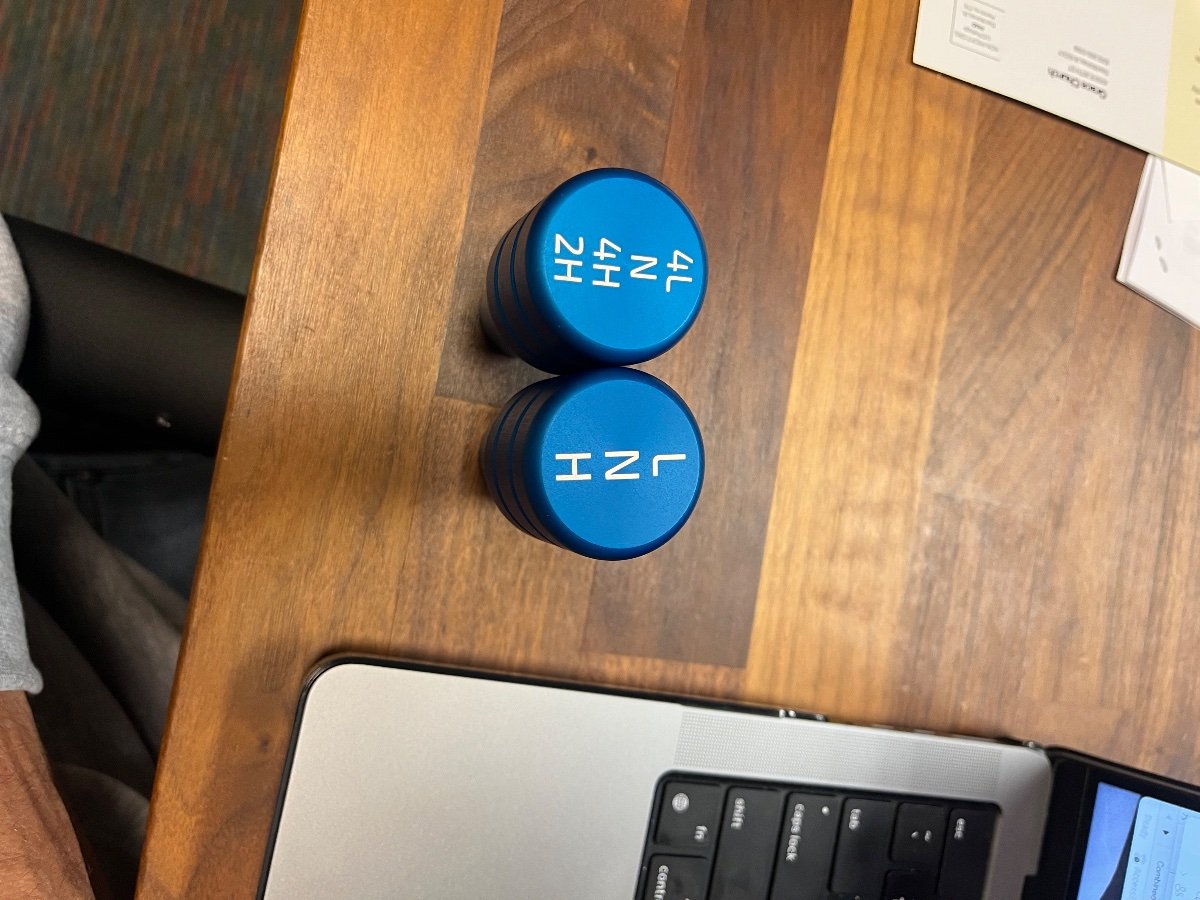

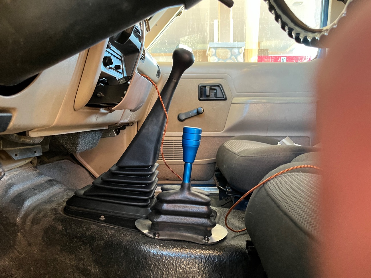

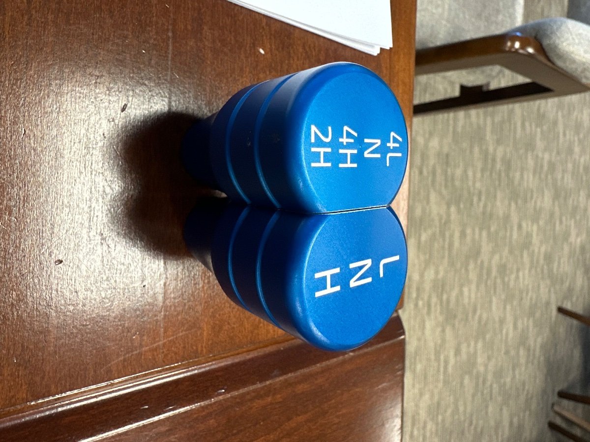

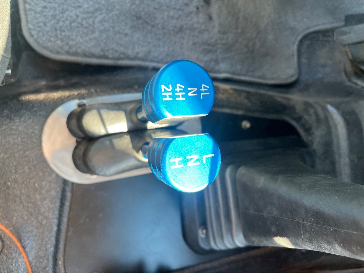

I got the straight shifters and bobs from behemoth, but the shifters were too big to be that close together. They also didn’t have the shift pattern. A guy at my work has a lazer engraver- so he did the shift pattern. Another buddy milled down the shifters for clearance for me.
All installed and everything clears.
