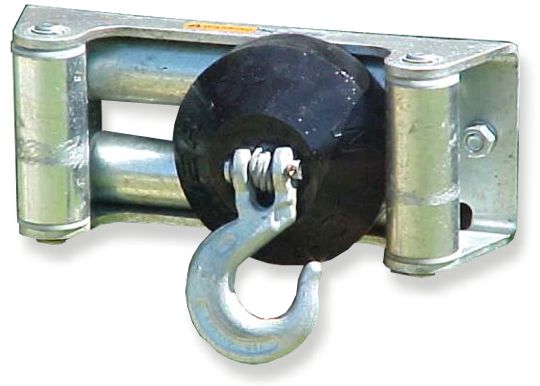

Winch Saver
Anybody heard of a Winch Saver?
Piece of equipment you should consider.
It's a urathane doughnut about 8" wide, 2 1/2" thick and you thread your cable through it then put your hook back on.
The doughnut cushions the hook when stowed against the farelead roller and is a instant cable weight when you string out your cable. I've been using one for two years.
Find them on ebay
Find them on ebay
you mean like one of these?
What is that for? I could see that giving you a warm fuzzy when you spool in your cable and think you have it stowed too tight.
I know when I broke that cable the chaps I had on it acted as a parachute. That donut isn't going to help slow down a busted cable.
