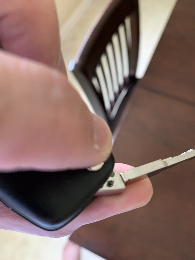

Just a quick tip, if your key is sticking or not flipping out at all. Open the blade out about 1/2 way and check the roll pin that holds the blade onto the fob. Mine somehow had walked it’s way out and was sticking out above the key base and dragging on the plastic housing. Small screwdriver tapped it back in flush. Key opens perfectly again.
