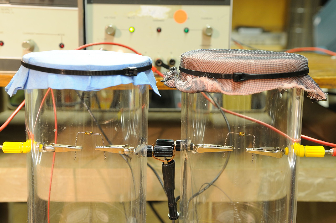

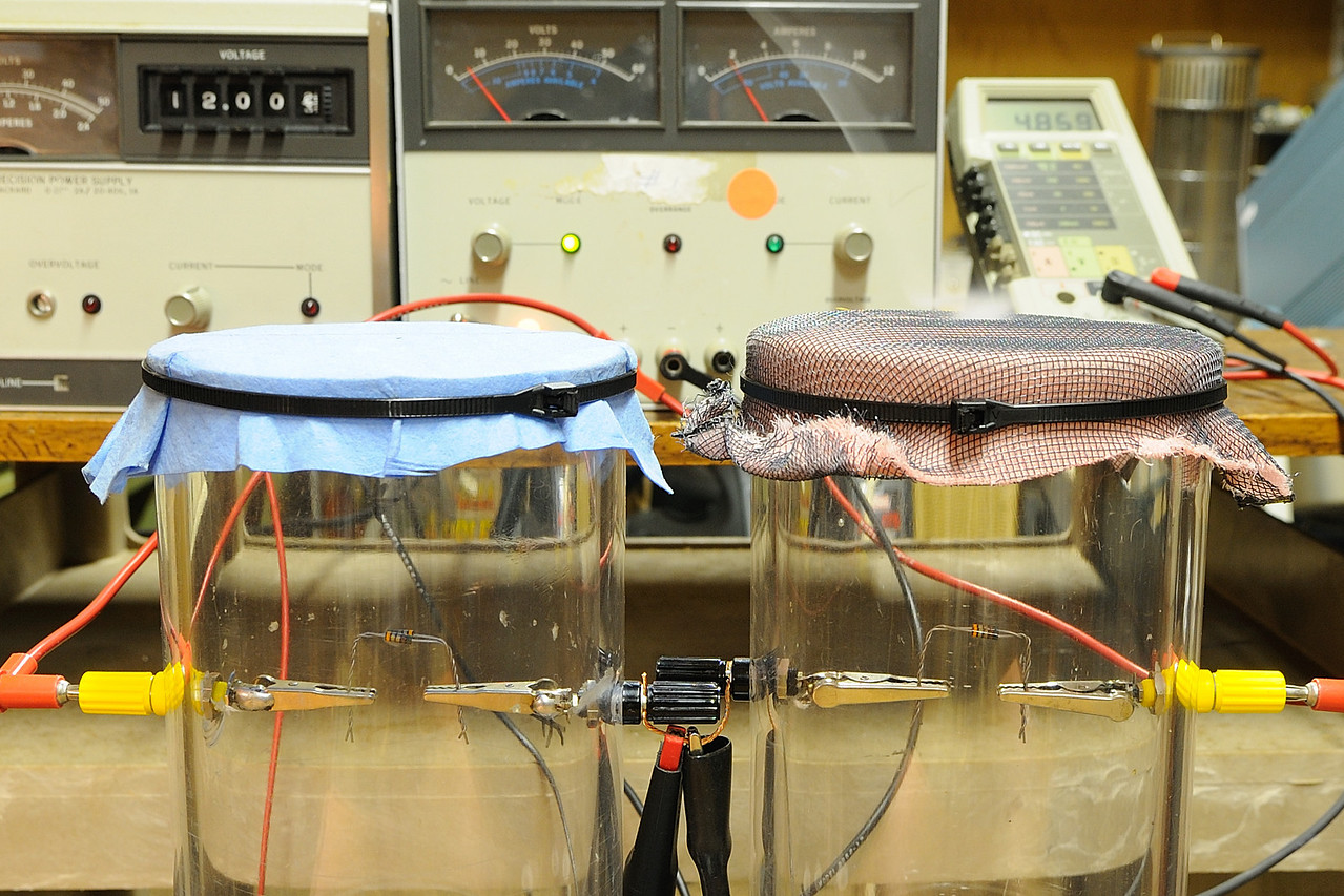

Ok, just to continue the comparison. Plexiglass tubes were used to make smoke machines. Carbon resistors were used to generate the smoke. On one end of the tubes was the filter media, and there was a fan on the other end,
which was not needed. Just the convection air flow off the resistors (smoke went straight up to the filter media) was enough to see the difference. As
you can see from the third photo, the OEM paper filter media blocked the smoke, the smoke went right through the filter media on the K&N:

This last so called test, has a very serious flaw, & actually explains why a paper filter requires several times the area of gauze to flow an equal amount of air.
Your small area of paper has nowhere near the porosity as the same area of gauze. Of course the smoke wont pass through easily, or at all.
Try it with 5.5 times the paper & show your results!

Sorry, you are dead wrong! the filter efficiency will stay the same, you will just get increased air flow capacity with the additional area. In the experiment the air flow was very low, just the convection off the heated resistor.
If your thinking was correct, the full size K&N would be passing marbles!!:D:D
