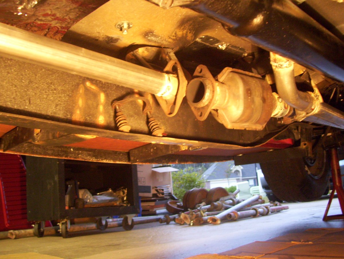

and I got the mini-cat off the 2.9L installed on the left side.....you can really see and smell the difference between the left & right mufflers.....the cat side doesn't produce the eye-burning carbon smoke & has a deeper rumble....
the right side is sooty with some water condensation & burns your eyes when standing directly behind it (and no......not looking into the muffler with my eyeball pressed against the outlet!!!.....that would leave a black ring around my eye!!!)
Definately gonna get another Ranger mini-cat for the other side (mini-cat = the smaller cat in the 2.9L OEM exhaust system)
I'm not a fan of cats (converters or 4-legged)....but this is proof to me for a daily driver that it runs a lot cleaner!

Only with the set-up I'm using/it smoothed the sound out & made it mellow/also cleaned up the exhaust smell & eye-burning fumes ****however if you like it loud n' nasty....ignore the cats.....LOL!!
The Harley mufflers sticking out the back are the only mufflers under the truk!!!!!!.....
The header is bolted on/extension tube is modified and bolted tight to the collector with the outlet pointing exactly where I want like in the pic....
...then go 6' (approx. at the rear of the cab to avoid a hot floor-board) and install nearly new mini-cat off of 2.9L engine using the flex-joint on the front of the cat adapted to the header extension tube like in the pic....
then from the cat---go over the axle to Harley muffler...
