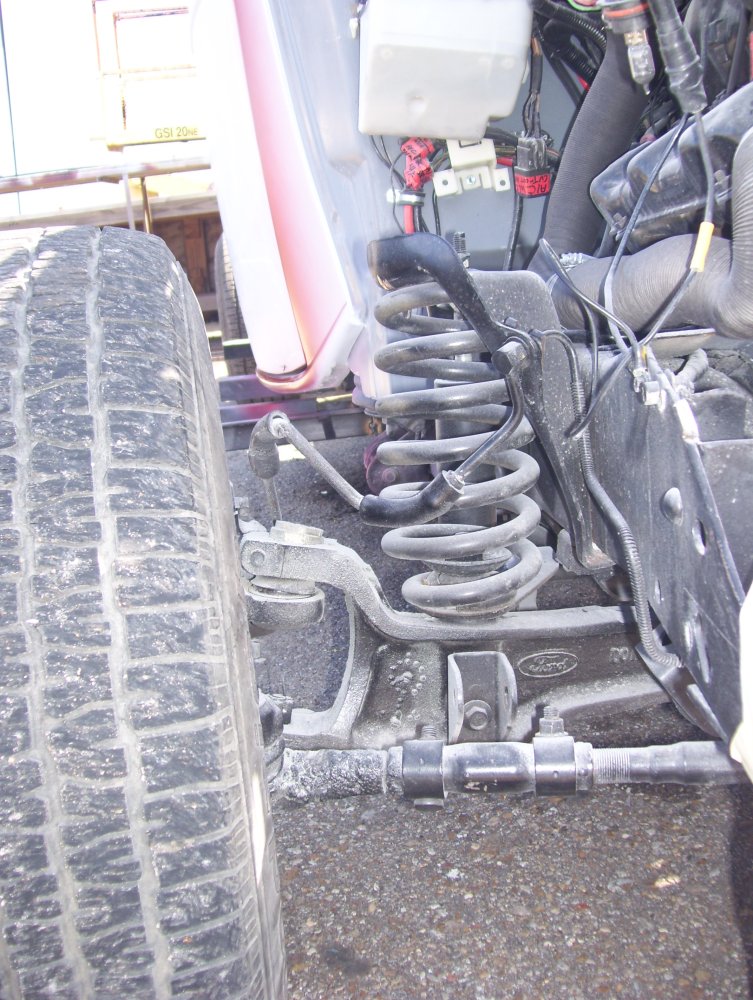

EDIT: I"m back.......imagine thses....these two blocks drilled & bolted to the front rails.....then the torsion bar brackets bolted to the steel blocks......Why?.......because when I lowered the front of the Ranger, the torsion bar was pressed against the tie rods....with the blocks installed, I'll have the needed clearance between the tie rods & the torsion bar...
Just Plain  Stupied
now......i-magine 2 of those 2" square tubes cut & welded to fit the rear frame as a tow receiver.....
Just Plain  Stupied
annnnnnnnnnnd i-magine the other two tubes cut & welded to fit the front frame as a towed receiver......
Just Plain  Stupied
