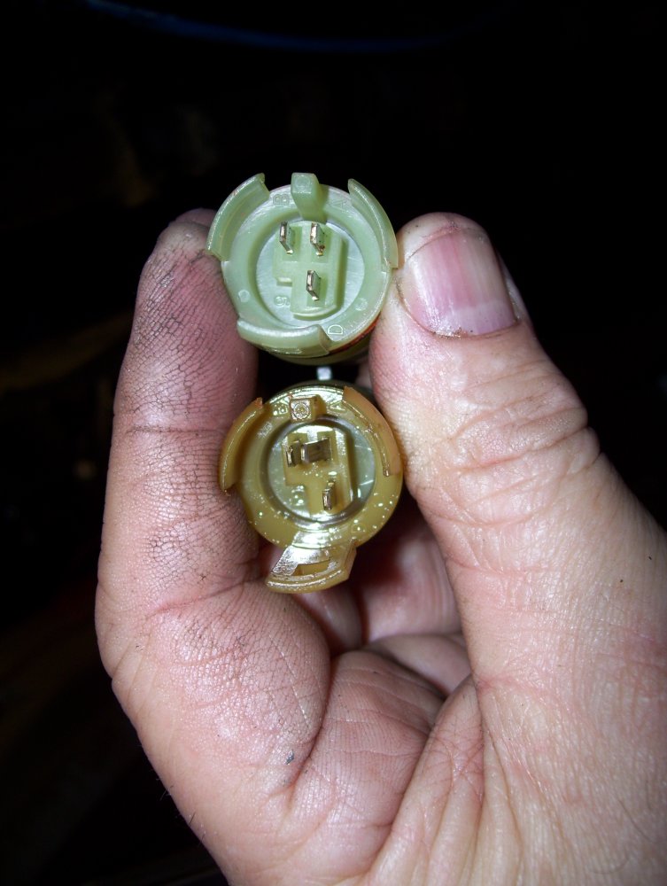

here' why the torque converter wasn't locking at highway speed......one pin was damaged by me trying to force the connector into it & the other pins were corroded....ahhh V.A. meds...it only took a couple months to figure the problem out.....

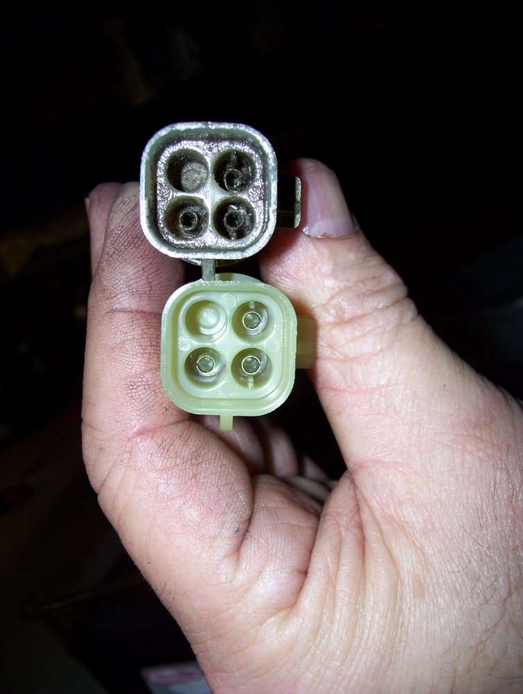

allllllllso.....look at the other end od the 20 year old case connector compared to the new one.....
