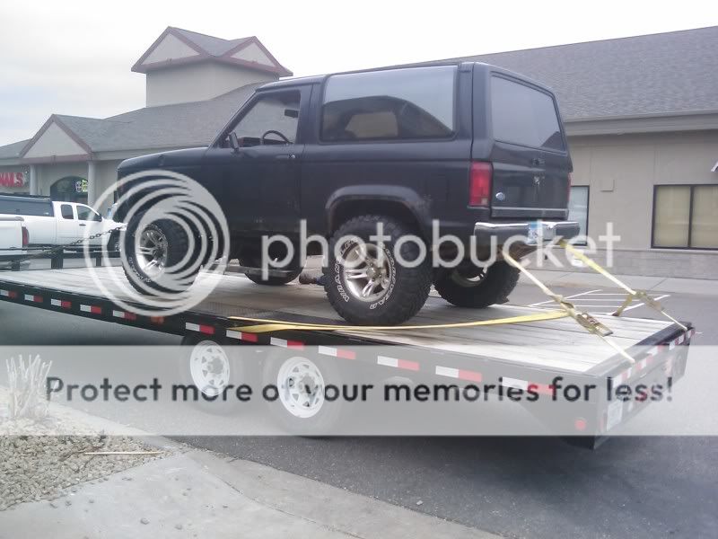

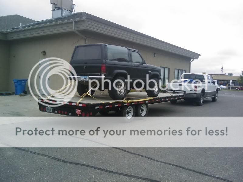

Found a good deal this weekend. Piked up an have a 88 ford bronco II i bought if for 500 Truck its a five speed manual 4x4 v6 2.9L tires 33in mud tires super lift think six inch lift. Things got three darn bran new full size spare "Goodyear MTRs". It looks to have a 6" tough country lift.
Of which some of it the kid lied about. No lockers or working 4x4. So tonight we looked into the 4x4 not working. And traced it down to the hubs. They were all loose! Fixed and put the warn hubs off my new BII. But still no 4x4? What could be wrong????????
Still don't know what rig I will go with and build up. Each has there faults but I think one good truck can be made of both. Heres the old b2.
