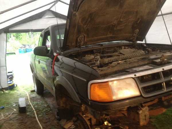

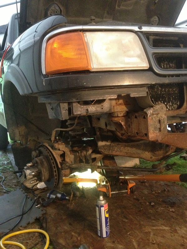

Well its up on blocks and I started unbolting the front end , or should say un-riviting every thing ,,, my lift came in on my second last day off so I only got things half started before I had to go back to the mine. I don't accomplish too much when I'm on night-shifts so I'll be back at it on Tuesday.

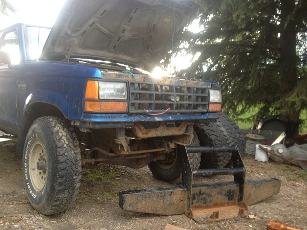

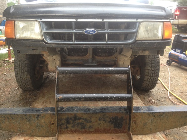

Surprisingly I don't have too much invested in it , most all the stuff came out of my bone yard , and only had to buy the 6 inch I beam and the 8500lb winch , I doubt I have $1200 into it , that includes the winch.
If you like I'll take a bunch of more detailed pics and post'em up on how I have it all set up . :icon_thumby:
For sure man post up as many pics as you want!:icon_thumby:
Well , it's been a busy last couple days . My 4 inch suspension lift is in , and got the 3 inch body lift all buttoned down and man am I ever disappointed.
The back end is sitting sky hi and the front end is still dragging on the ground. I rolled the 35's under and bolted them up and still not a chance in hell of turning the wheel.
I have scoured and search all the old threads on swapping out coils to the f-150's so now I'm gonna take a walk down the hill and do some measuring on a couple old 150's I got . Hoping i can get the front end up off the ground a couple more inches. :dunno:
