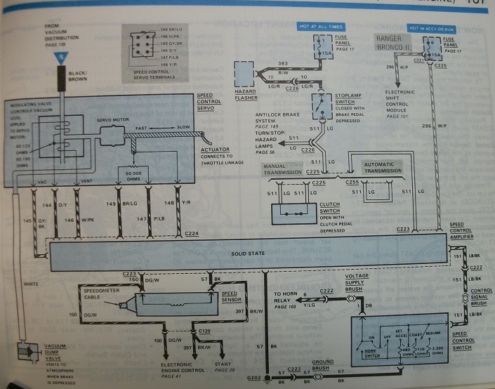

Actually, 1st and 2nd generation Ranger cruise controls DO use the brake on/off (BOO) circuit, AND the vacuum dump valve as a backup "failsafe" cruise disengagement.
1987 EVTM (images were handy), but '83 through '94 are pretty much the same (1995 and up are not in my wheelhouse, so I don't know much about them).

On a manual truck, the brake light circuit also goes through the triple function switch operated by the clutch.
Another interesting thing to keep in mind, that in addition to the cruise system disengaging when the brake light circuit has +12V (brake pedal pressed), it also monitors the wire to be grounded, brake pedal not pressed, in order to allow the cruise to be engaged in the first place. This is how the clutch switch can disengage cruise- ground goes away, and that's why a lot of times when LED tail lights are added, the cruise control stops working; because it can't "see" the ground anymore.

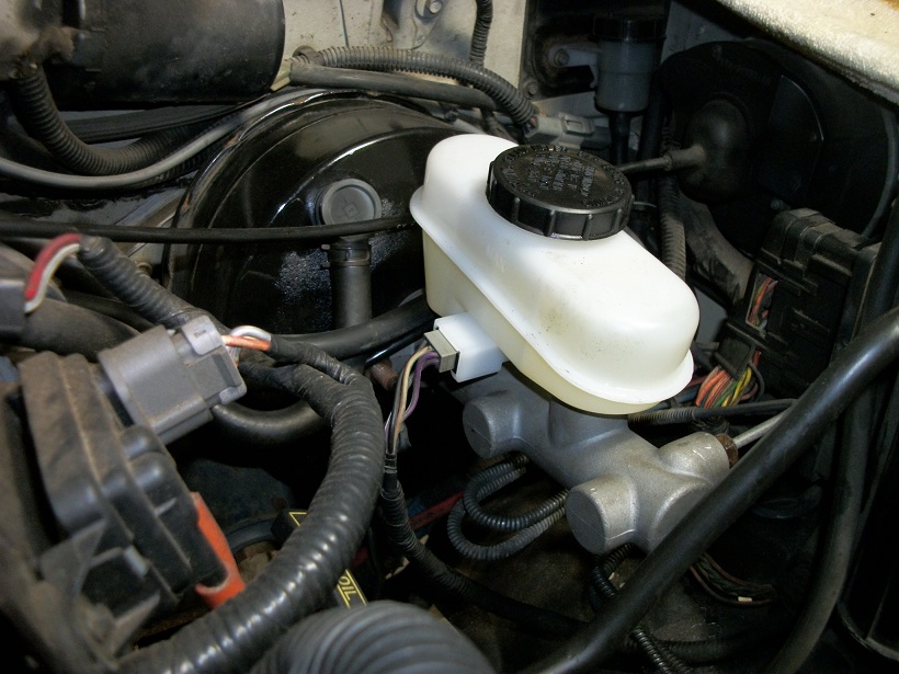

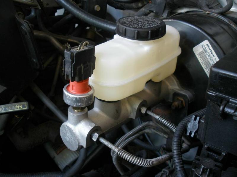

well now you just saying "And for the record, I'm not aware of, nor have ever heard of, the master cylinder being different for cruise control. " directly contradicts the tech article and what I was saying in bold flat out terms....
this tech article (which is for 3rd gen +):
says you have to swap your plain ole master cylinder for a master cylinder with an electronic switch:
"New Brake Master Cylinder with C/C deactivation switch (part #F67Z-2140-JA) "
last pic at the very bottom of article:
and that matches what I (remember 3 months ago) having seen in the junkyard, in the 3rd gen + they had 2 different master cylinders, those with factory cruise had the switch, those without looked the same even the emboss, just no drilled,tapped port for a switch.

I had to put a master on my white Explorer ('94) four years ago:
No switch.

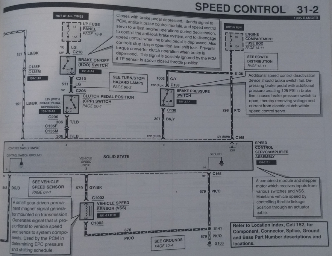

The master cylinder/brake pressure switch is the failsafe for '95+. Terrys87 doesn't need to worry about it if he's installing a stock donor system.
A new cruise master and switch pigtail can be had for $30 from rockauto's "economy" section, so I do think there's little excuse not to include it if you're adding cruise to a '95+.

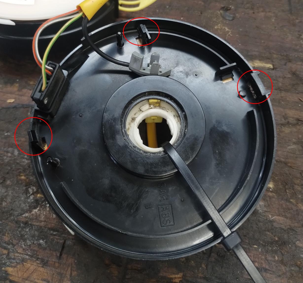

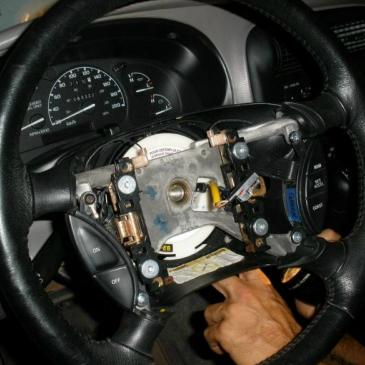

In that vein, I'm sure this information is already a dozen different places on this site, but since google sucks now, you remove a Ranger clockspring by pulling the cover off the steering column and prying open these 3 plastic tabs on the back, one of which immediately snapped off and flew away:

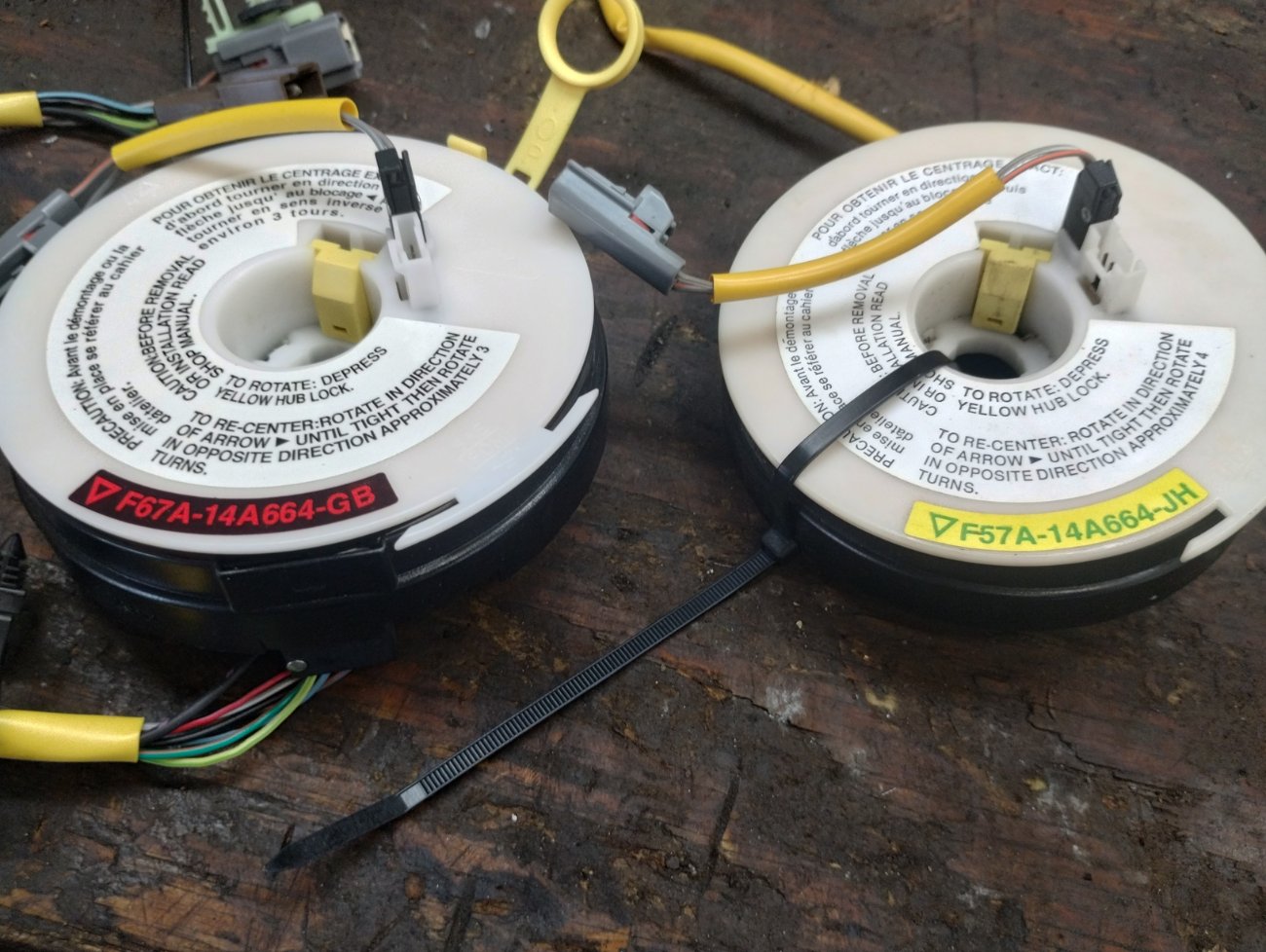

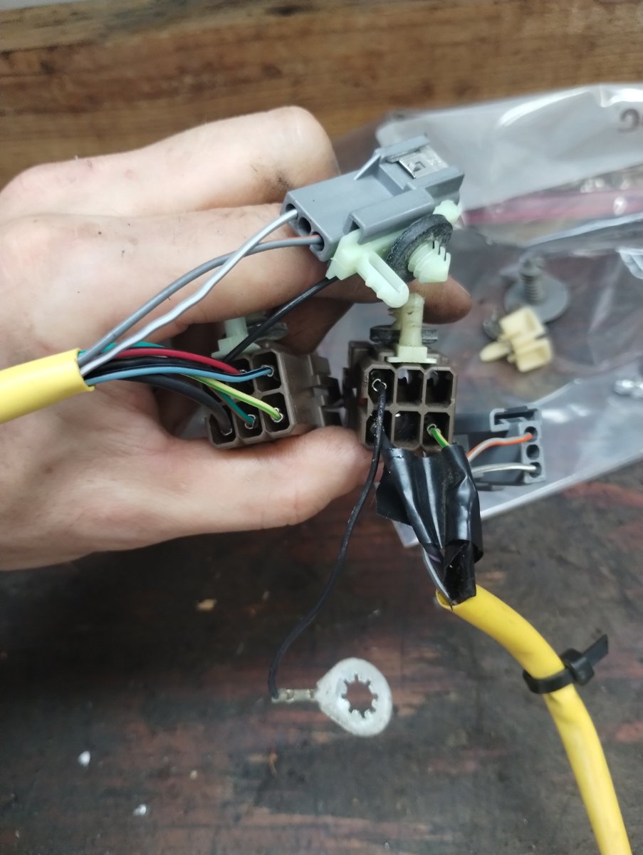

The NOS clockspring I bought was listed "either w/ or w/o cruise", which I guess is technically one way to describe "w/ cruise". There's an extra pin in the long narrow connector on the front, and 3 in the square brown harness plug:

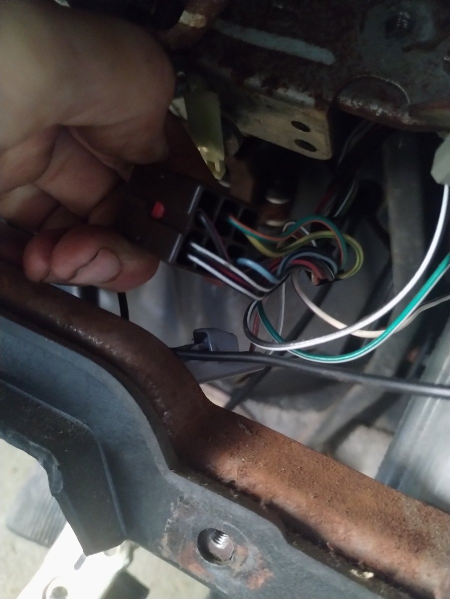

Fortunately, all of the pins are populated on the truck side of the harness:
Haven't checked for the plug where the cruise module lives in the engine bay yet. Now that I'm under the dash, a PO hacked the ignition wiring all to hell, so I'll probably spend the rest of the day sorting that out.
EDIT: Okay, cruise is good to go. Based on this bright orange sticker I found tangled in the wires, ignition hacking was because a PO had a DUI interlock at some point. Cleaned up without too much trouble.
Overall, adding cruise to a '95 is considerably easier than a '94. There are fewer pieces, more of them are actually available to buy, and most importantly, the truck was completely prewired.

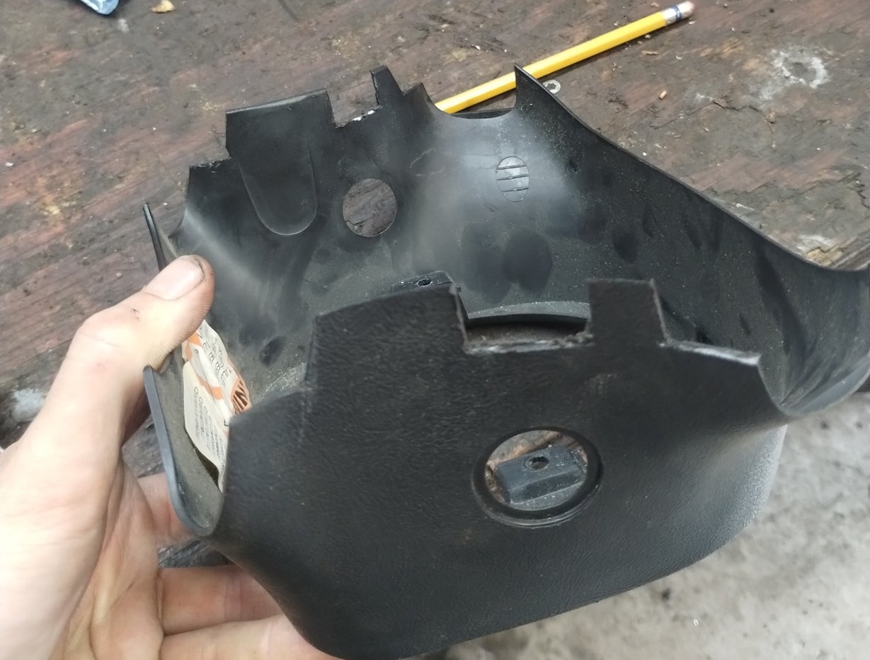

This is the minimum amount of material you need to remove from the rear steering wheel cover to accomodate the cruise controls. I guess you could also just make straight cuts across.
You don't need a donor wheel, and you can get replacement controls basically anywhere. I used interior door strike screws with the points ground off.
It's possible to reinstall the air bag module too deep so it's shorting the horn contacts, and the horn goes off when you hook the battery back up.

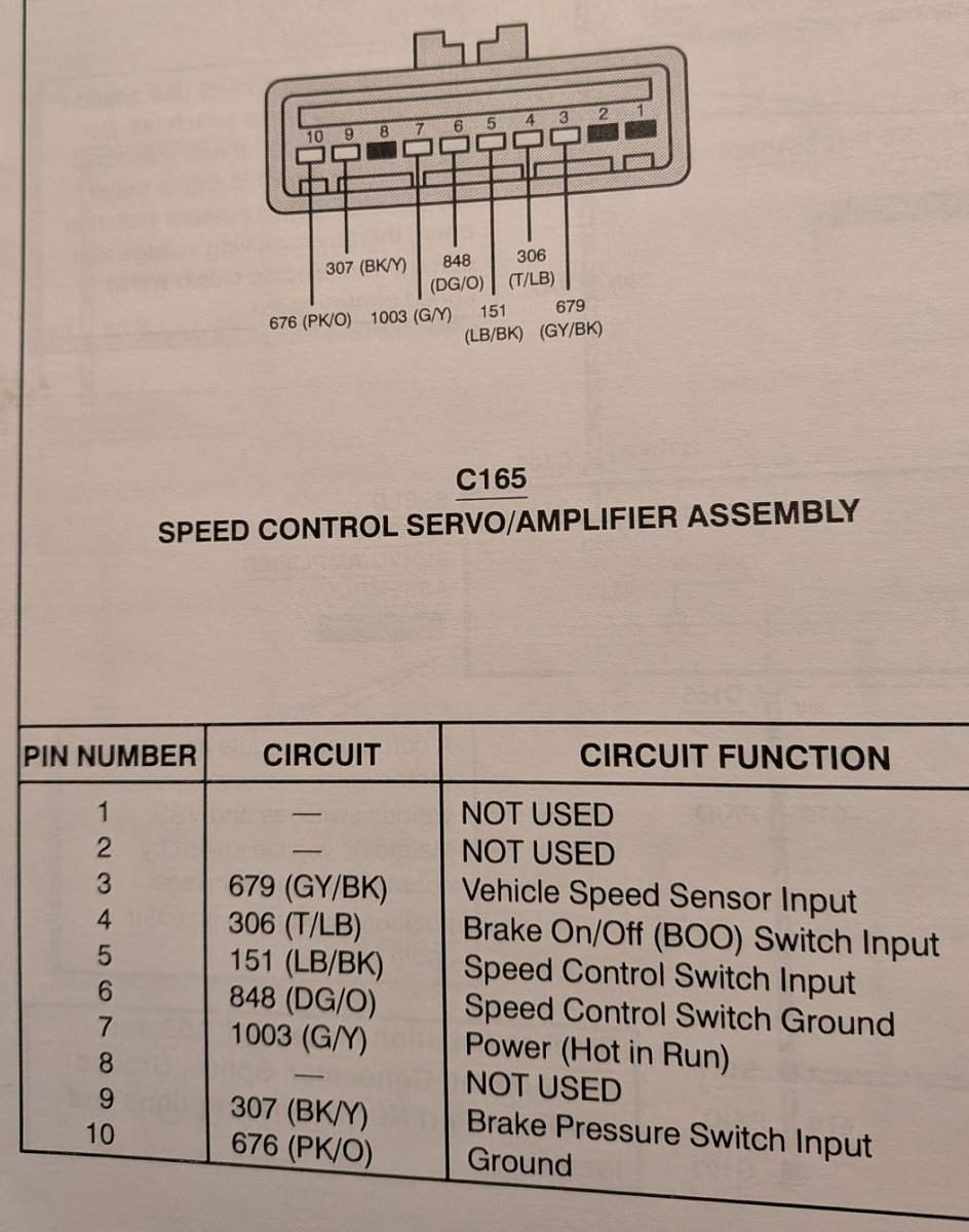

The combined servo/amp was prewired, and bolts right on to the closest fender bolt.
The master cylinder pressure switch (also prewired) is NC and opens when you brake, so even if you're bypassing the failsafe system, you need to plug in a switch or otherwise jump those wires.

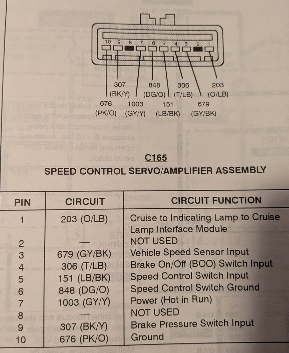

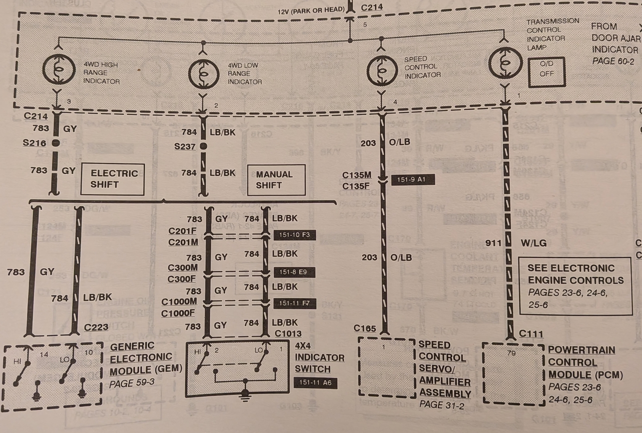

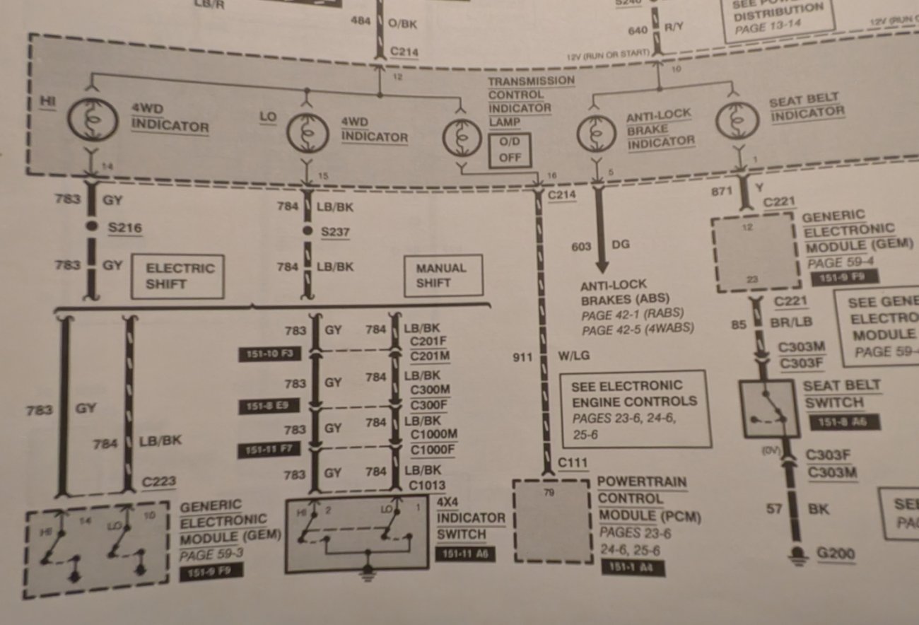

Okay, not the end of the world, but can anyone else with a '95-'97 confirm if they have a working "Speed Control" light, or does anyone have the Instrument Cluster EVTM diagrams for '96 or '97?
My bulb was good, and cleaning the contacts and replacing it anyway didn't change anything. The '95 EVTM does not show a "Speed Control" light in the IC, which makes me think this light just isn't used on '95 Rangers, if not '95-'97 entirely.
I see a "speed control diagnostics" procedure floating around about holding Cruise OFF while you turn the key, and that doesn't light it up either. Not sure what year that's supposed to start.
