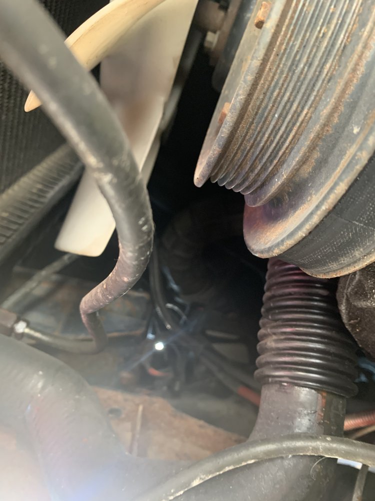

I haven't read the other 5 pages so it may have been asked and answered already but have you tried to just watch it while it is running to see if you can see where the leak is coming from? I had a pinhole in a brass fitting that would only leak when it got up to temp but would stop leaking when the t-stat opened. Only saw it when I sat there with a flashlight for 10 minutes and it finally sprayed out the pin hole. Other idea would be to check the reservoir for leaks. Maybe you have a small crack in the side just above the water level and it only leaks when it splashes from taking turns or something....
Any smoke from the exhaust when running?
Do you hear bubbling in the reservoir when you shut the engine off after it has been running a while?

It’s not internal.@BabyBlue im not 100% sure the big chain stores will pressure test your cooling system.
Its pretty simple to do though, basically just attach a pump to the radiator where the cap goes, pump it up to the pressure it says on the cap (13lbs is my 87 2.9, not sure on yours), and watch for coolant to spurt out somewhere.
If its dropping pressure with no coolant being seen...you might be in for a head gasket or something. IIRC 2.3s are known for it.

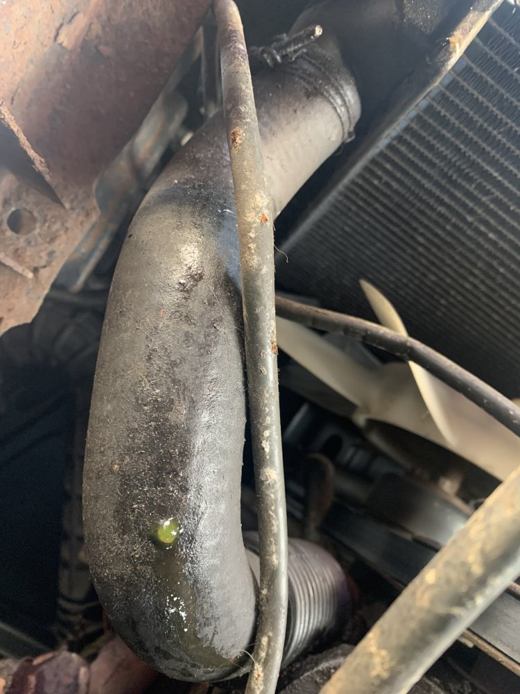

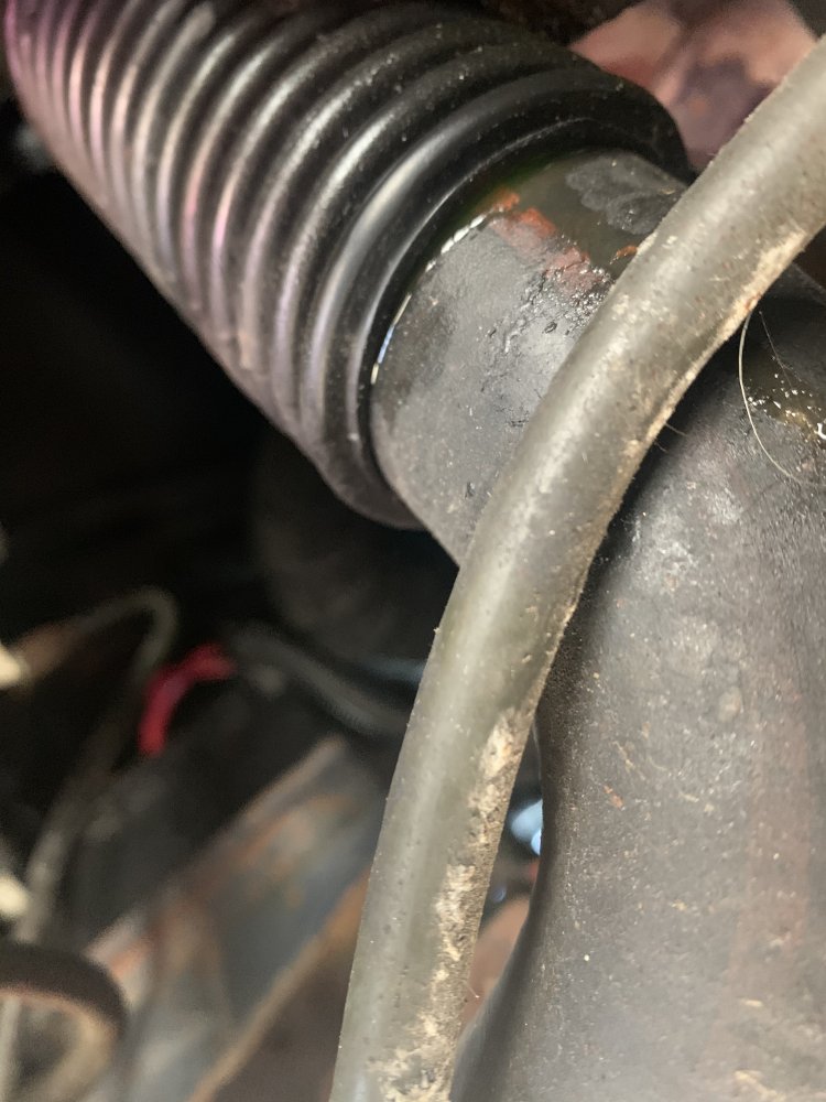

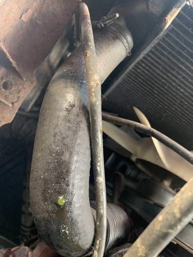

Found a source this is where is leaking. No other places.Yep.

So the lower radiator hose is chafed? There is a drain on the radiator, you will need a big bucket also lol I'm sure the gentlemen have told you after 7 pages..

That’s the plan. I’d prefer to drive her than my 2018 Mazda right now.Chances are its just the radiator hose.
Swap it out and keep on truckin
