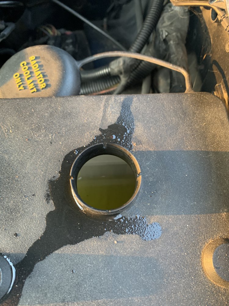

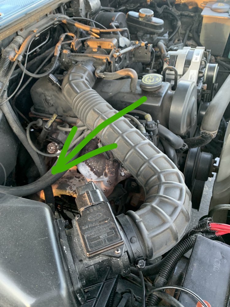

re route the heater hoses higher.
OK bear with the Tom Girl here can you identify for me the heater hoses?
Which ones are they?
They simply need to be up higher?
OK why?
So I understand...the technical reasons.
even just tying up to intake tube....they look close to the exhaust manifold...though that maybe a picture trick. like north dakota.

These are the heater hoses.

If you have wetness on passenger side floor, especially if it smells of antifreeze, replace the heater core. I would replace those two heater hoses at the same time and route them higher. Do it all at once and you won't have to open that system again for a long time.
