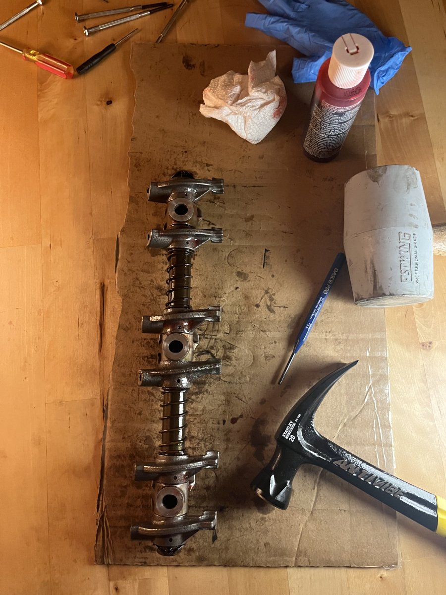

Just replaced the rockers. Just follow this video for exact walk thru:

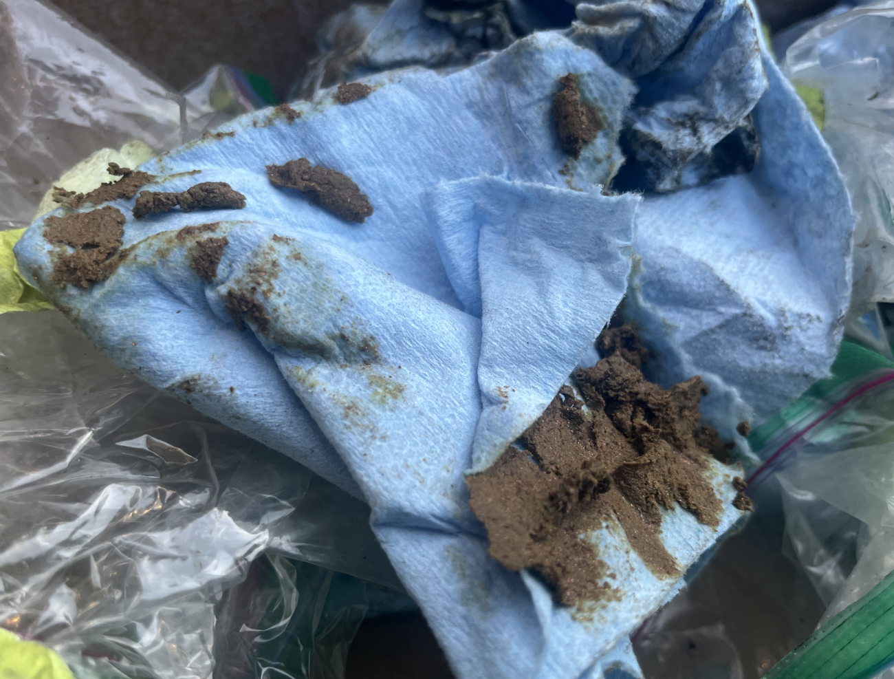

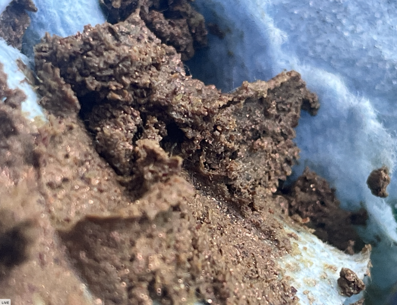

Next up will be dealing with my coolant issue. It doesn't seem to have a coolant leak anywhere, but there's a ton of sludge buildup and what appears to be glitter (reminder that I just recently got this vehicle with minimal maintenance history). Going to do a coolant flush and swap when the temps warm up, and a rinse with evaporust thermocare. But this may be the next project......
Photos attached of just some of the sidewall sludge i was able to scrape off the coolant reservoir with a chisel.

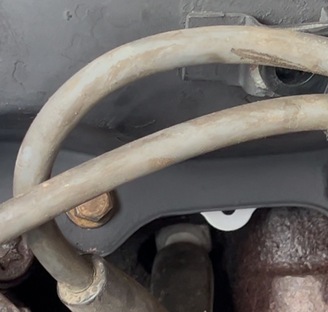

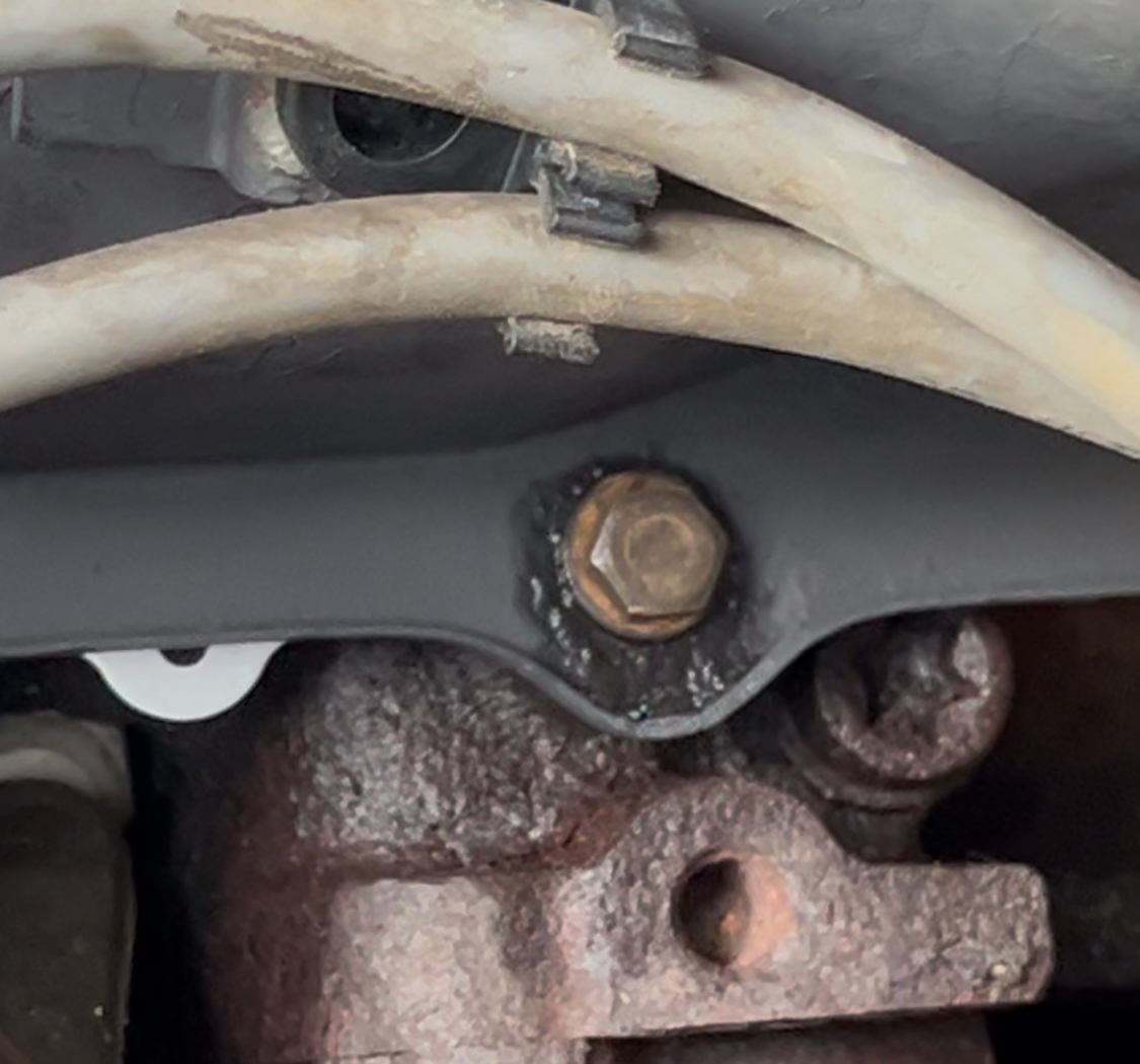

I wasn’t able to torque the valve covers to spec because I don’t have an inch pounds wrench. But tightened as evenly as possible. Two bolts (luckily the easiest to access) have some residual coming out of them that seems to be growing. Maybe that means I need to tighten a bit more? Attached pics of the “bad” and “normal” bolt heads for reference.
otherwise fun and successful project!

You are missing the spreaders on those valve cover bolts.
They're visible in this picture:
I'm not gonna say your truck had them, but my first engine didn't and I couldn't keep the bolts tight. I came to the conclusion that the bolts were hitting the bottom of the hole at the same time as they put a little tension on the gasket. I had to re-tighten every oil change.

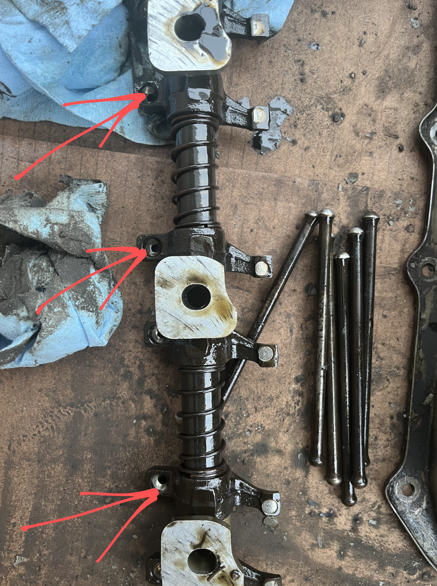

The wear to your rods is the amount missing on each end added together...it's enough to cause a tick. The area to inspect on the rocker is here (red arrows in pic), in the cups.
Smith Brothers sells replacement rods, custom length rods, adjustable rods...even titanium rods.
Delta Camshaft of Tacoma Wa. has the only remaining supply of reinforced cup OHV 4.0l rockers.
The adjustable rods and improved cup rockers should save you the most money in the long run. The are only a slight increase in cost over OEM replacements, which, when installed in a used engine may still tick do to related valve train wear.

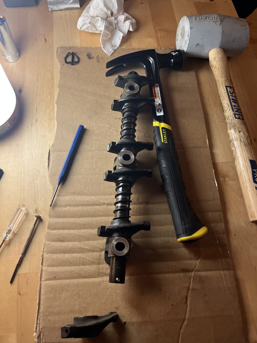

Heres the deal my son was "helping during tear down. Went inside the house for a couple minutes came out and he had mover the rocker arm assemblies and couldnt remember which one is which. I intend on rebuilding them and new pushrods so im insure if it really matter which one goes where. They seem to line up either side with no visible indicators..
So you're just using the pedestals and shafts? Shouldn't matter then. They SHOULD be the same. I'd sanity check the oil holes on the bottom of the pedestals tho.
