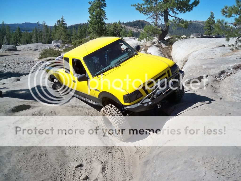

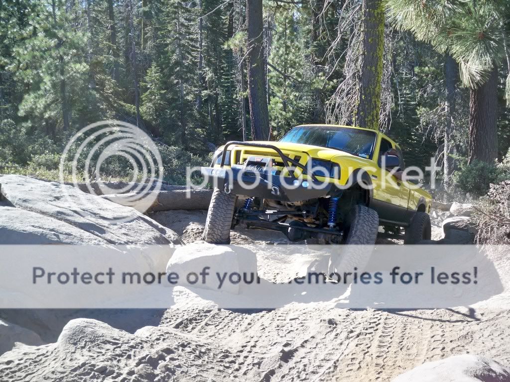

here are a couple from Mammoth Mountain

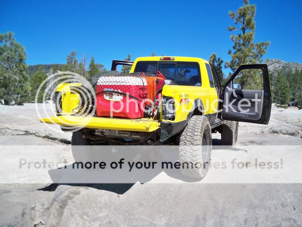

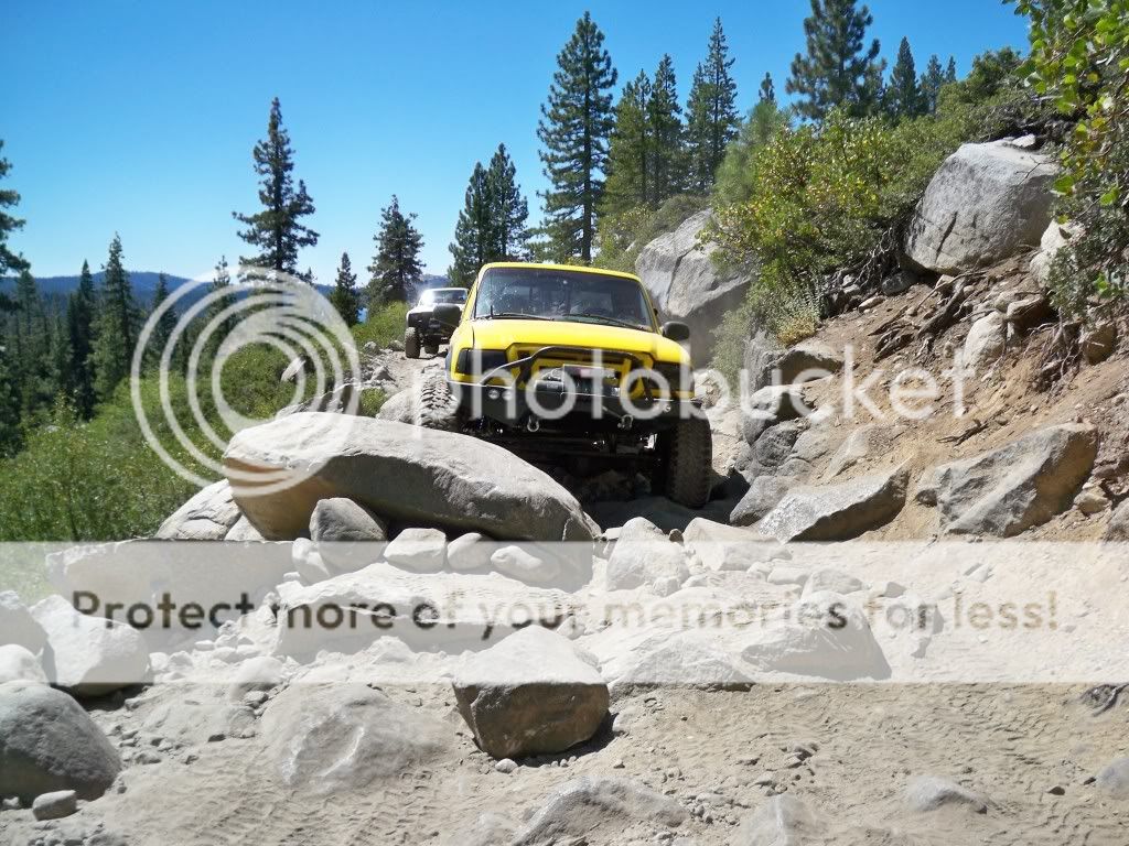

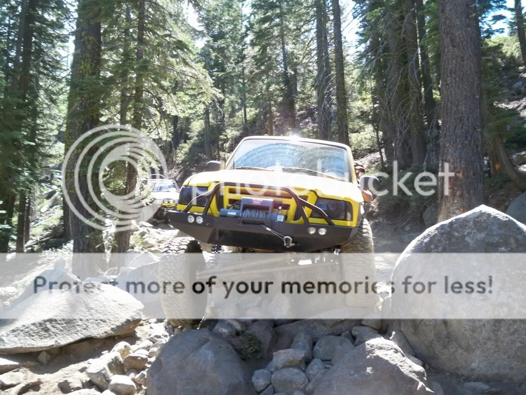

Then it was off to the Rubicon Trail. I was confident, i had extra shafts, tools, bolts, leafs, and even an extra driveshaft. That wasn't enough....
Here is how it began....

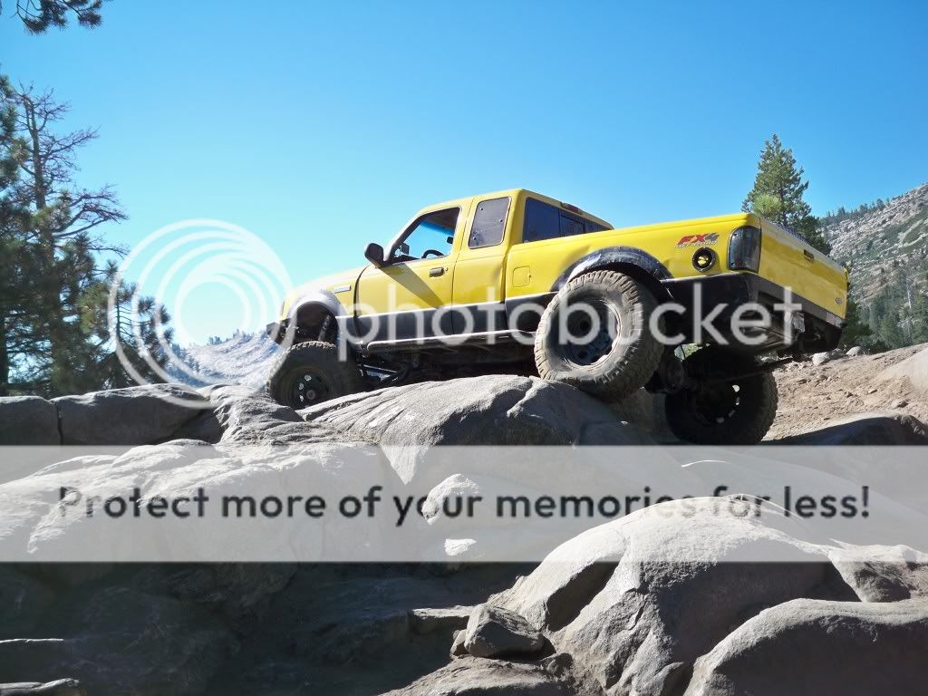

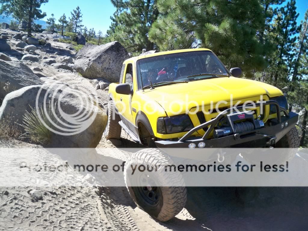

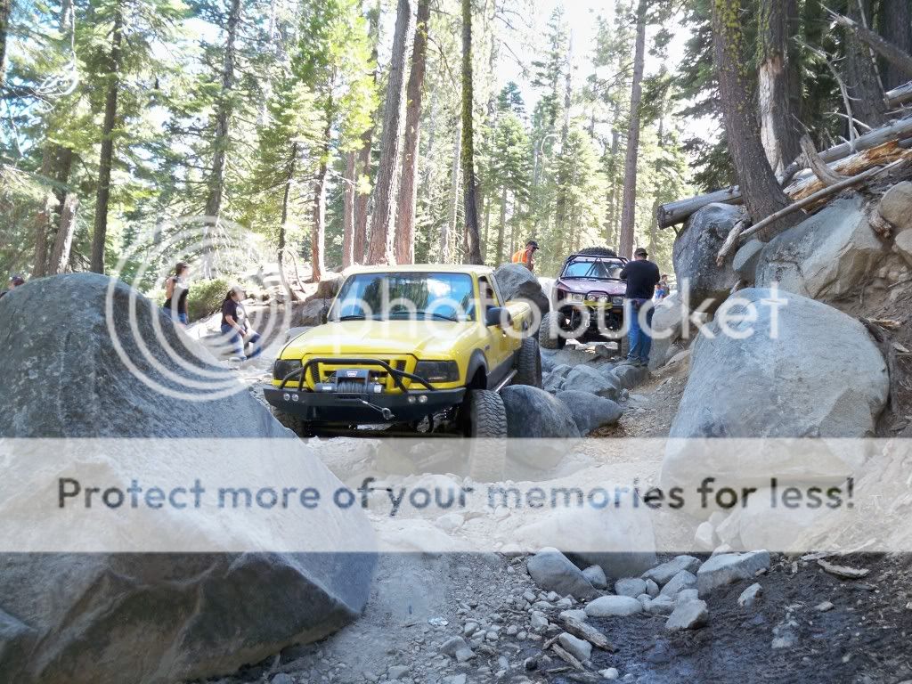

then shit started to hit the fan....
Josh40601's Build Thread. (D-ranged)
I high centered and ripped the first driveshaft into 2 separate chunks....

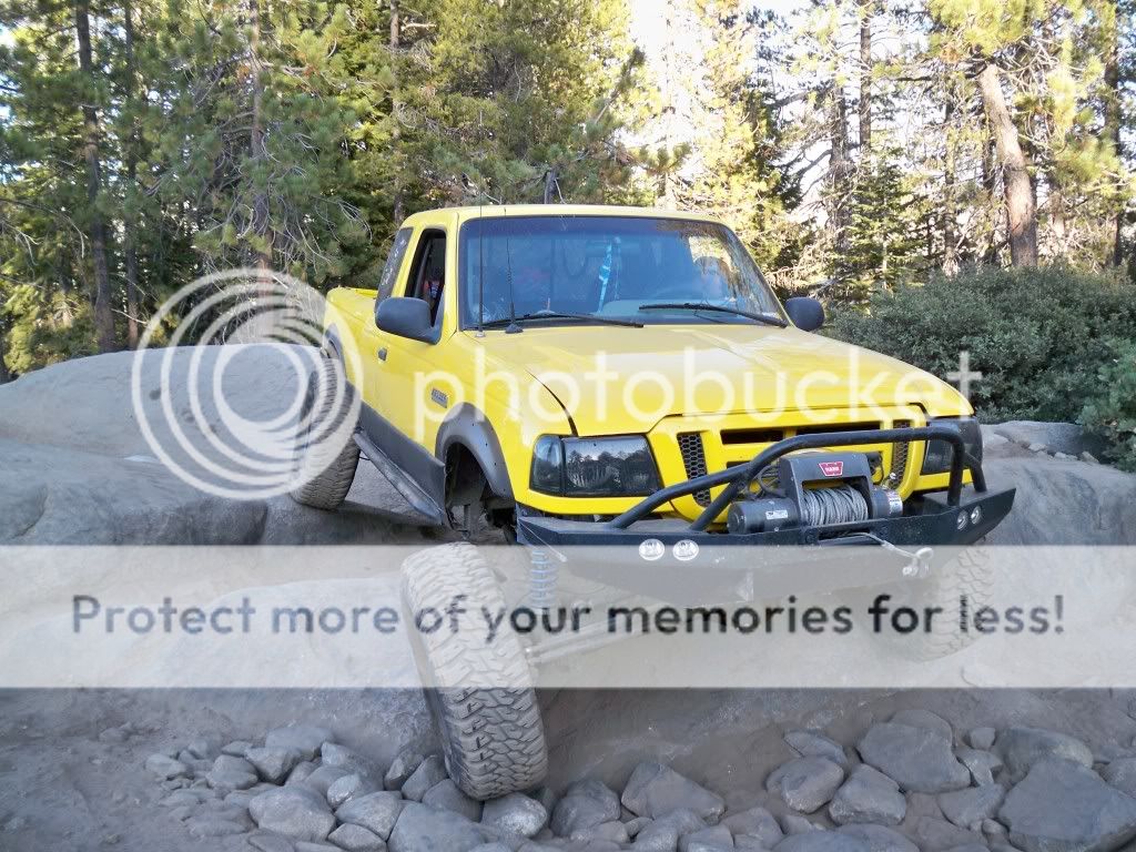

This became a very common position for this trip....

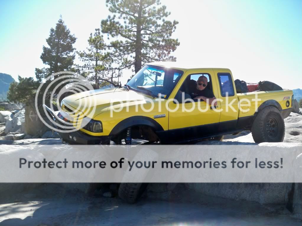

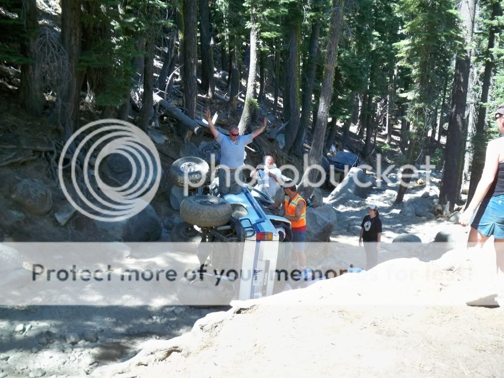

then i found out i was only running in 3 wheel drive when i couldn't pull up on this rock....
So we pulled off the trail, and swapped in a slug i had bought a while ago from ZainyD and it worked like a charm. 2 breaks within 2 miles... Not looking to promising, but easy and quick fixes, so we were back on our way.

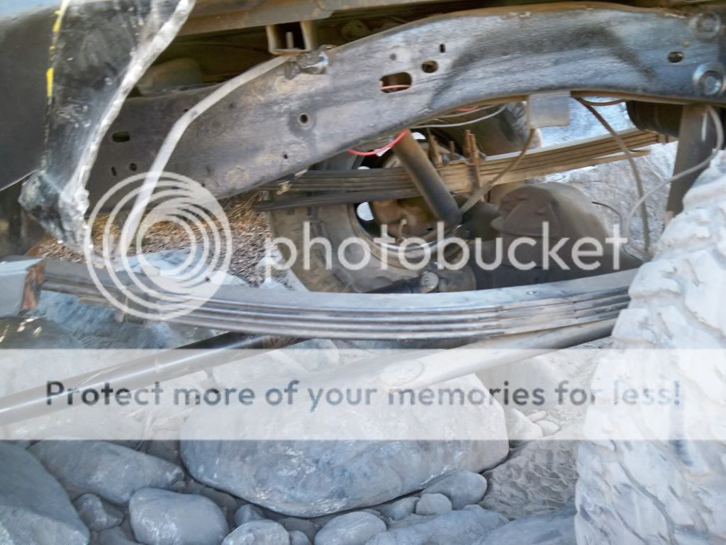

Right after Little Sluice is when it got REAL fun.... The center pin on my driver leaf spring sheered....
(Forgive the pics, we were more interested in fixing it and not blocking the trail)
After a new pin, removal of the overload and busted shim, recentering the leaf pack, lining the axle back up, and gettign the driveshaft back in (about an hour or so), we were back cruising the rocks again. By this time, i was done. 3 breaks in 1 day on 1 trail is enough. Although i was fed up, the groups i had met that helped me out told me it was easier to just keep going than turn around, so i listened (dumbass....)

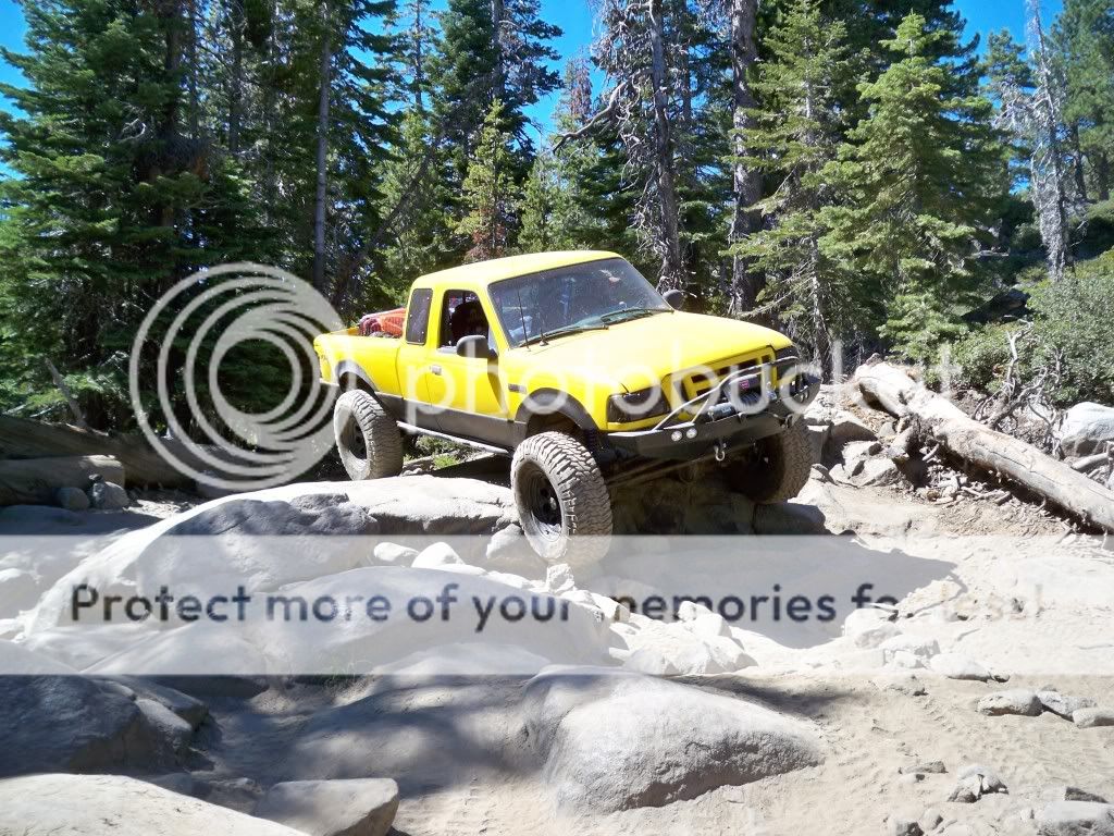

I jumped in with this group, and they showed me the way until Rubicon Springs, where everything went well (for me at least)

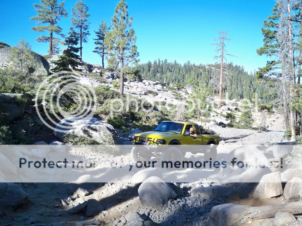

Here are some shots coming down Big Sluice

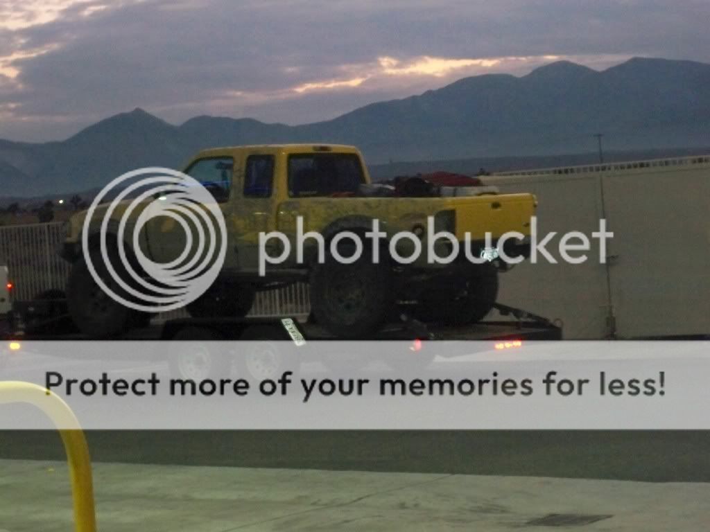

Here is Bee on the trailer. Beaten, Bruised, Broken, and ready to just kill over.
