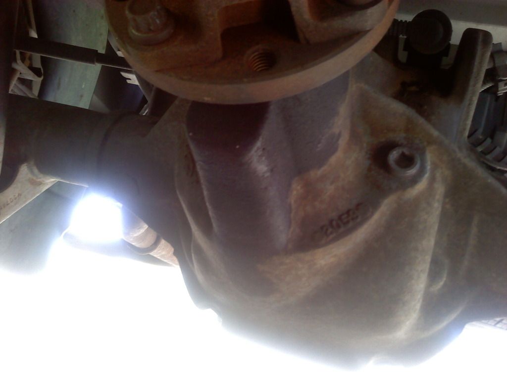

Yeah the maintenence records show that the slip yoke was cleaned and lubed back in 06. i'm thinking it needs attention again. where is the slip yoke located? and in front of the differential where the driveshaft meets the diff, you can see where something's been leaking
well I got it looked at and i guess nothing was wrong, its just the way these trucks drive, and I could have been exagerating the severity of the jerk a little. but while I was there they found that my rear axle seals were leaking so i got that taken care of.
