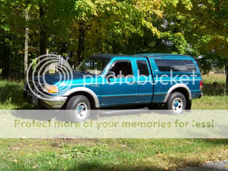

My jeep fims fit just fine and clear eveything. 99 xj rims

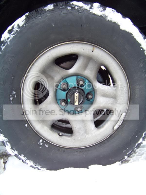

i have steel wheels from a '01 wrangler that i run in the winter on all 4 corners and have no problems. D35 front axle, should work with the BII as well. they dont have as much offset but they clear the calipers just fine.
its about time to switch mine back to the factory alloys.
That is the same style that I had for my spare it would not clear on my 84 BII. And, NO, it was not a bent rim. Possibly the D35 caliper is mounted "lower" or closer to the axle centerline, but on the D28, it is a no-go. And, yes, the Wrangler has the same offset as the XJ.
