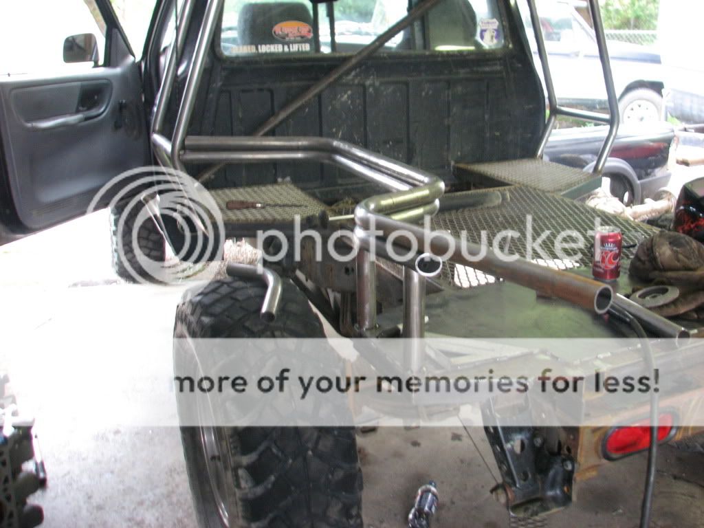

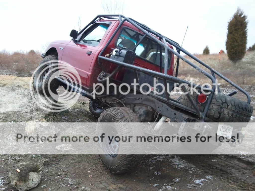

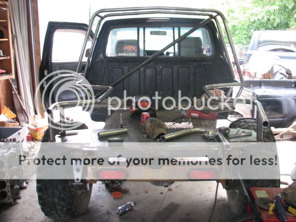

Greg ( 97TrailrigDD ) did all his tube work with 1.5 and I think it looks pretty good, and functions well on the trail....
