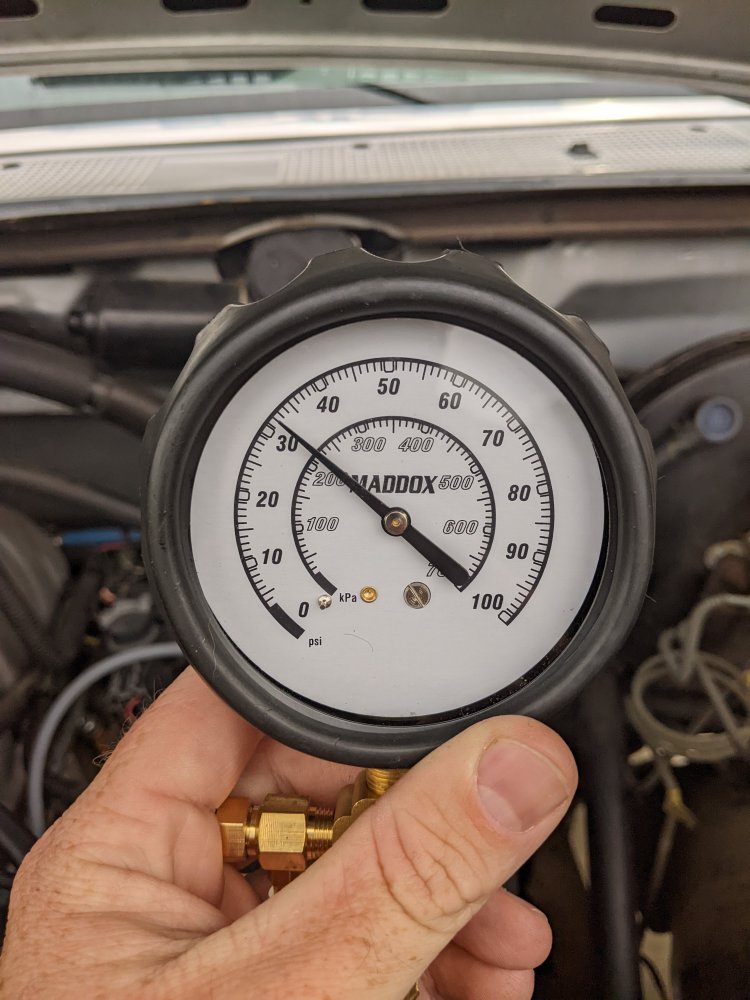

I'll confirm the fuel pressure first tonight then move on to check other items that for the DTC to begin with.

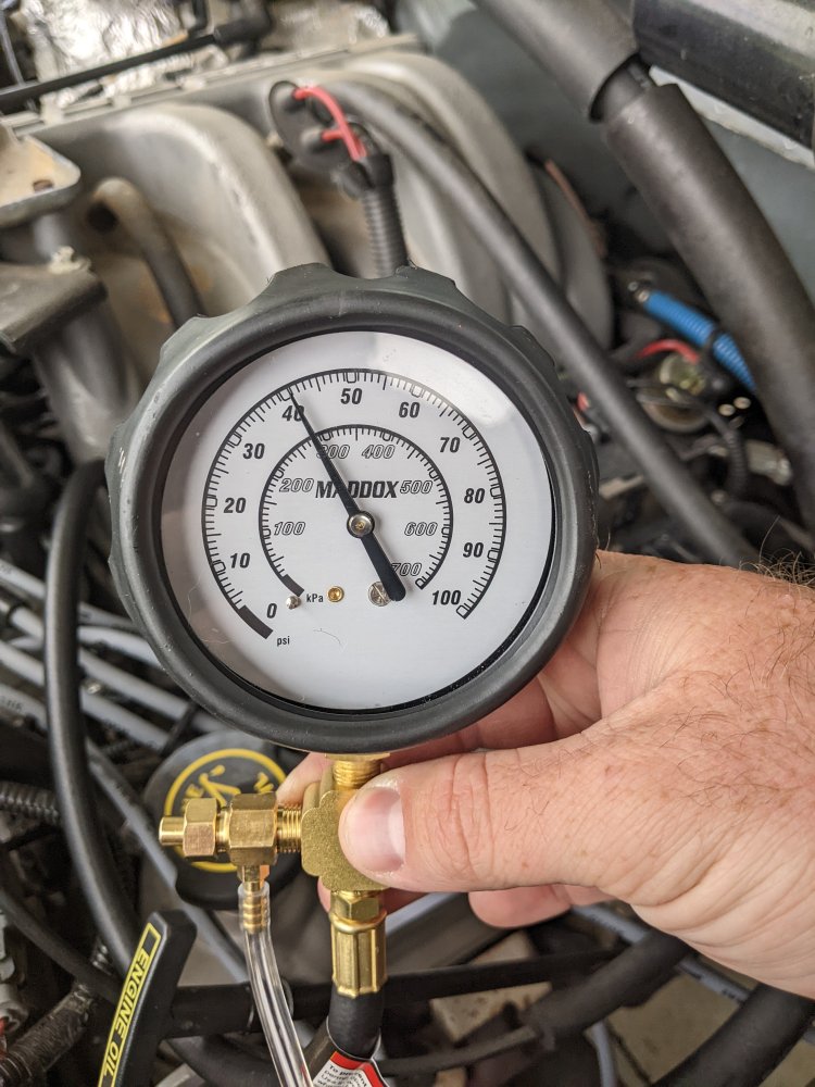

So, knock the fuel pressure off the list. Key on non running it is 30 psi, fuel pressure regulator unplugged it is 40 psi, with it plugged in it's right around 32 psi. I believe that's inspect for this year 5.0?
