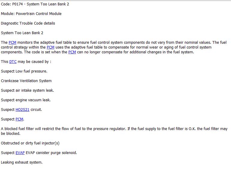

Also getting more detail on the P0174. Makes me wonder about the fuel pump as well, one has already failed, could be the other one? Guess I can check fuel pressure.

Bank 1 is passenger side
Bank 2 is drivers side on Fords
Thank you for that. I couldn't find that solid anywhere on the the Internet.
All plugs are firing. I think I'm going to rent fuel pressure tester to see what I have at the Schrader valve on the driver's side fuel injectors.
