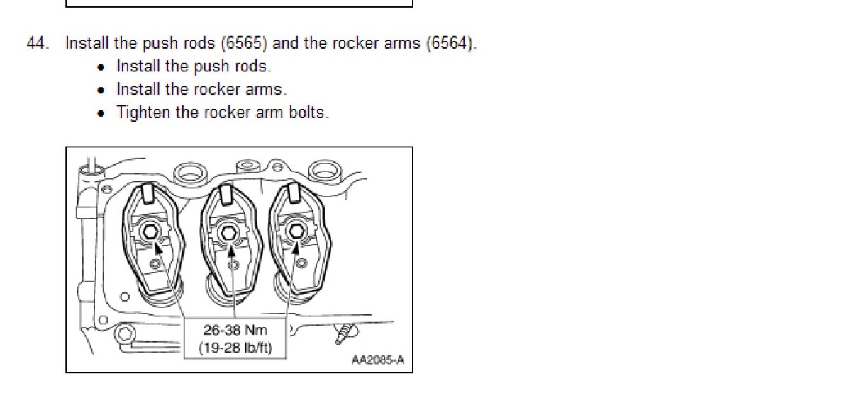

I"m not sure what you book says for adjusting valves. and rockers arms. I didn't see anywhere that there was an adjustment for rocker to push rod. There is just a toque spec for the rocker arms. two should be slightly loose even after torquing. I had a slight knock after head gasket replacement. I manually dropped some oil on top of rockers and rods. I attempted to prime the oil system but I didn't get any oil shooting out. I didn't have a operaable battery so I didn't have a way to build up any pressure. If you didn't toque down your rockers I would say that is where the tapping is coming from.

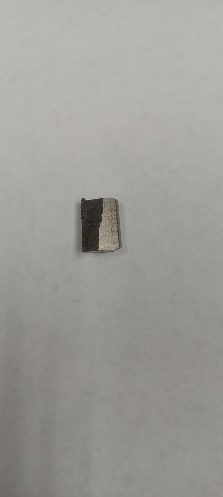

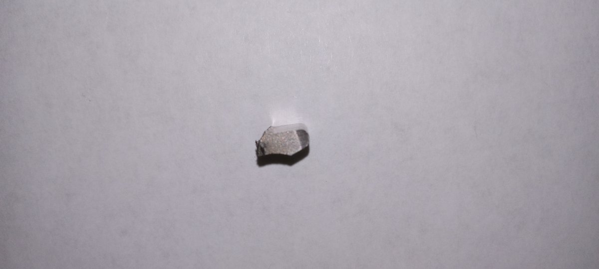

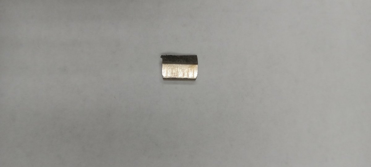

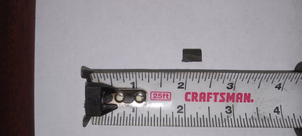

Yeah, that is the exact spec I have I found in the guide online and used it. It was a 2 part torque spec and I did it to all of the rockers. So over the weekend I removed the oil pan and installed all new rod bearings fearing I had rod knock due to oil starvation or improper installation. I found 2 con rods that had a significant amount of play in them so I changed the whole set of bearings which are not old and have probably less than 200 miles on them and looked good. I figured I was in there anyway mine as well replace them and retorque them to be safe. I'm glad I dropped the oil pan because I found a tooth from either the Crank gear or the timing gear. I think the issue with my ticking and lifter noise is due to missing that tooth, the timing of the motor might have jumped or could be jumping while driving. I would also say that it's highly probable that some of the noise I'm hearing could be due to a slack timing change. If anyone has any idea if those symptoms seem plausible I would appreciate any input, also how the hell would one tooth break off in the first place? Maybe I got a defective gear but I feel like a true failure would have been more than just one tooth.
Any input on my assumption that this is either from the crank or timing gear?
