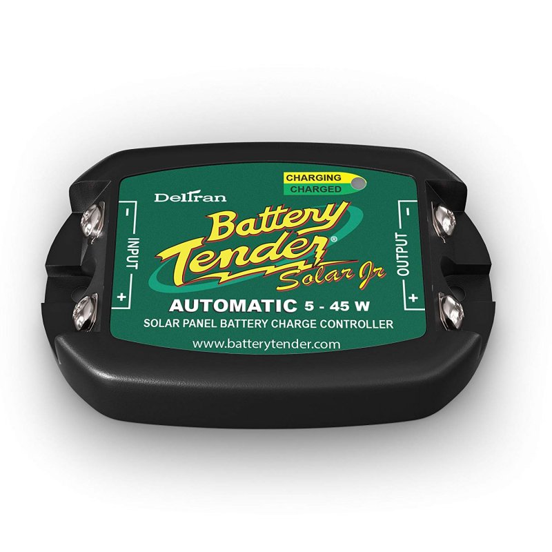

I wanna put a 25 watt or so solar panel on my truck just to keep a little trickle charge in it when it's not being used and not near the house. I had a all in one little gizmo but it stopped working and didn't do much to begin with...
I know I need a controller first. Found the battery tender solar jr which seems to meet the specs.
Is this all I need for a solar charger system?
I want to mount the controller under the hood permenantly, run the wires into the cab and install a plug on the dash so I can stick the panel on against the windshield or throw it on the roof.
I found this for a panel
Newpowa 30 watt panel
These two gizmos seem good? Anything else I need besides just wiring them up?

So will these things work or what!?
I was looking at this yesterday, but it is more money. Got good reviews.
Thats pretty cool, kinda out of the price im willing to spend... if the controller and panel im looking at work im only spending 50 bucks and 30 minutes of wiring.
