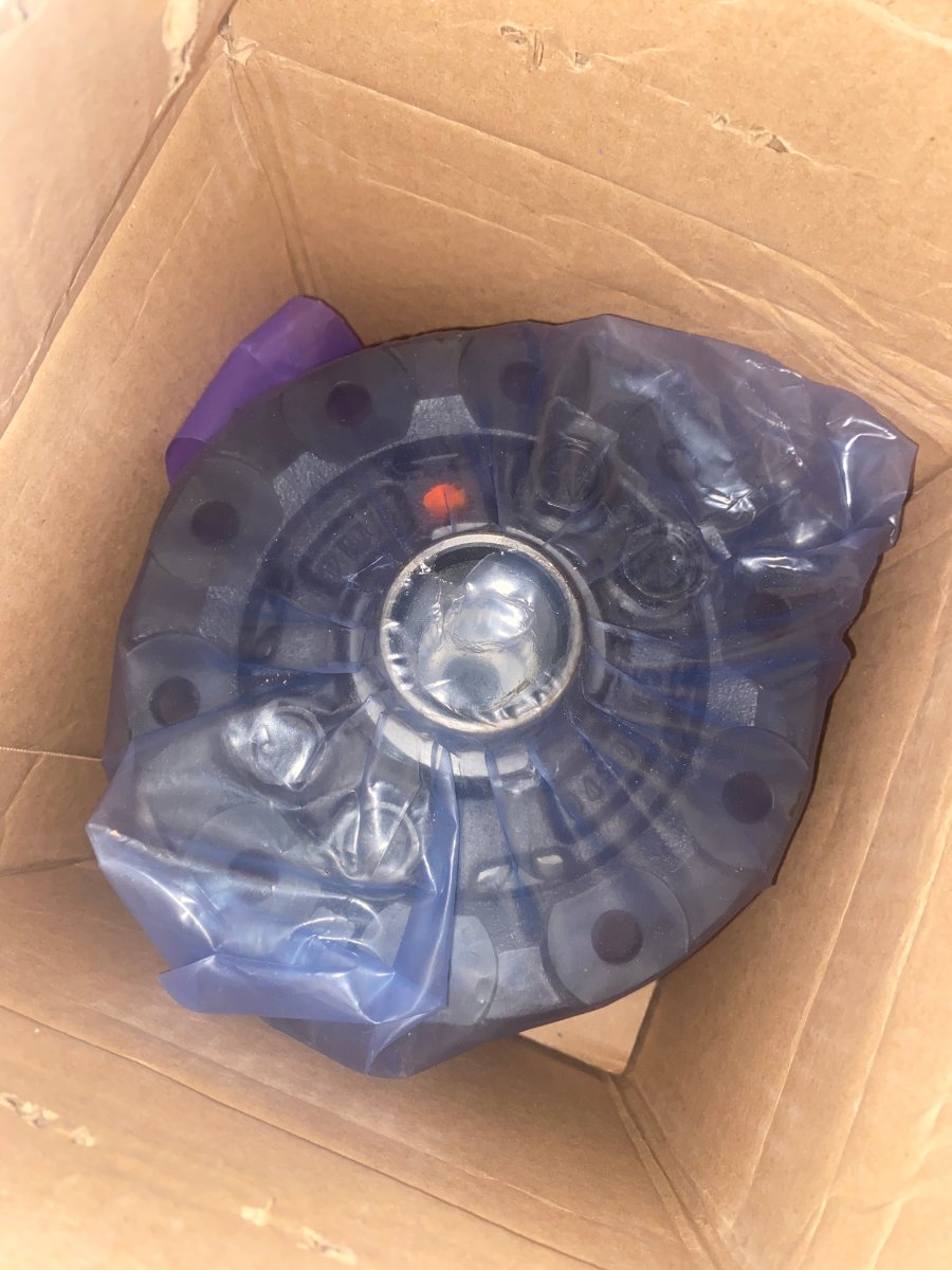

I was looking to rebuild an 8.8 I bought off of here over from race dezert classifieds, and put in a different diff with a 4.10 gear from a sport trac rear I am using for its brake parts, instead of pressing on the 4.10 from the donor sport trac rear end. While doing some research about the trac-loc diff, I came across this t-2 torsen diff out a ranger fx4 level 2 31 spline preloaded at 30ib-ft on sale on torsen.com. linked here (Torsen® Traction)
I never seen this site nor can I find the exact same part in other places, just the torsen diff mostly found in mustangs. I was wondering if I should pull the trigger on this somewhat sketchy site, or would I be better suited getting a locker later and just sticking to the trac loc and buying a rebuild kit in the meantime.
Looks like a steal to me. It is on the Torsen website, seems like it is legit to me. As long as you have the correct housing/axles, personally, I would go for it.
it says that it works with the explore rear and housing and the description 97 to 01 i'm pretty sure I have a solid rearend from that timeframe, but I also have a sport track solid rear end from a 04 same spline.
All of the '91-02 explorers or the sport tracks with the solid axle should work fine, they're all 31 spline with the ABS tone ring
Looks like the deal is gone. Hope you got yours.
I got it
