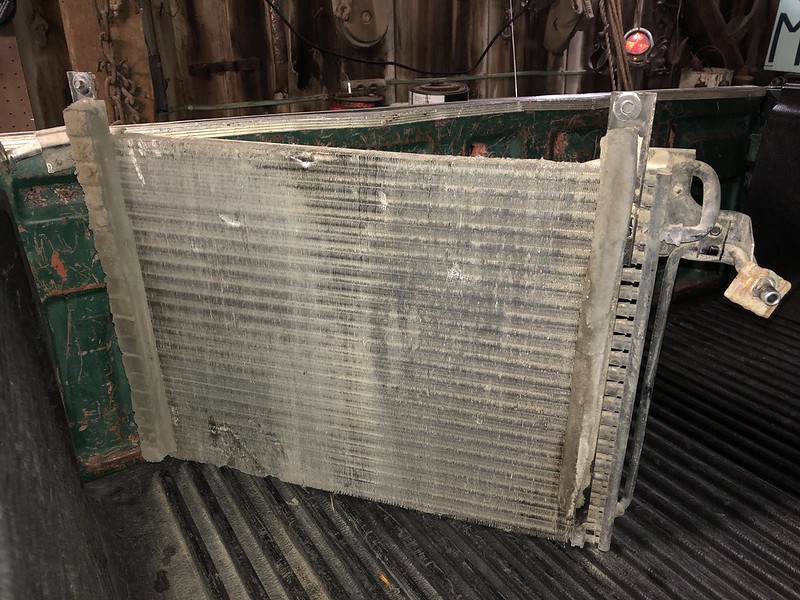

The '90 I pulled the condenser out of over the weekend did have big clips over the connectors you use the tool for. Mine pried off, I have them clipped back on here:

To use the 4.0 lines you do nee the 4.0 condenser, but be aware that those hook ups are not in the same spot as the 1st gen condensers, and you are going to have to cut your core support a little to make it fit.
That is a 4.0 condenser.
