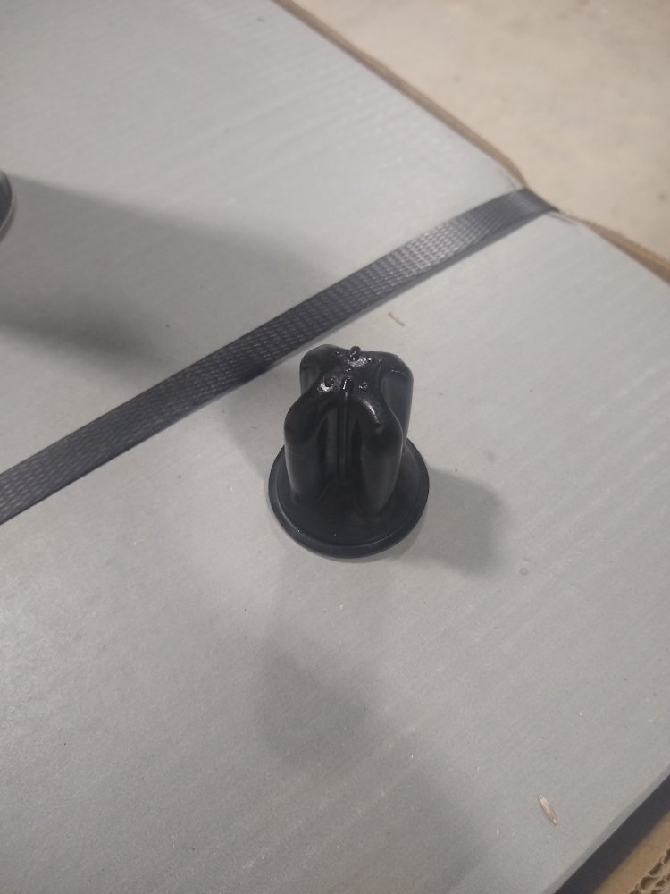

What does this bladder do and is it necessary? For context, I'm changing the clutch on a 1998 ford ranger mod-5od.
It is not absolutely necessary, but it helps to reduce moisture absorption into the brake fluid.
This reduces the frequency of flushing the brake fluid. It may also reduced the sloshing of the brake fluid in the reservoir to keep it from leaking out of the cap vent.

It stops the fluid from spraying out the bleeder hole when you push the clutch
I agree, The "bladder" seals the fluid from the air and prevents it leaking out the cap event on bumps, while still allowing for the fluid level drop when the pedal is depressed. There isn't much fluid volume so you don't want to lose any and the fluid will attack the paint it gets on.

I thought the bladders were there so a suction effect didn't happen as parts wear down. Which would collapse the cover and let air into the system.
The cap has a vent hole in it. Without the bladder in place, the reservoir will leak when you go over bumps and the fluid inside will absorb water and degrade. IMO it is a necessary item for those reasons. Will your clutch function without it though... yes.
