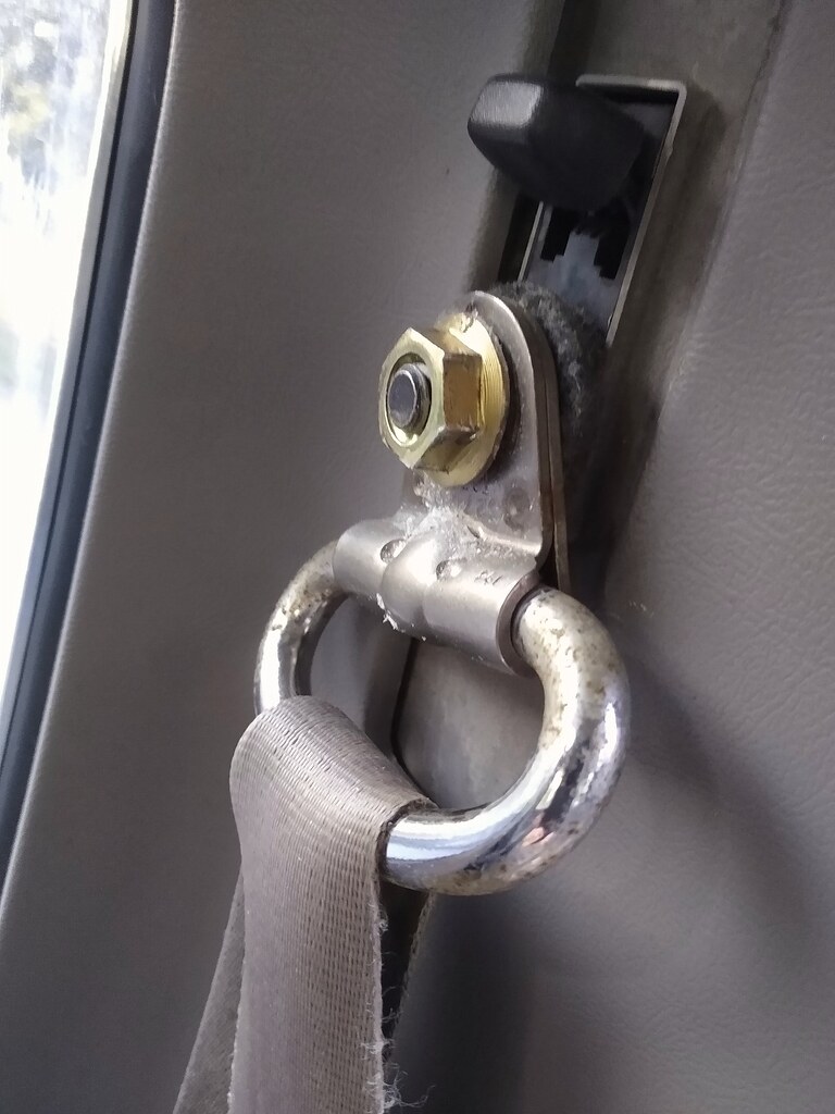

I am redoing all of the interior in my '96 Ranger. I'm trying to get the seat belts out to replace them. This bolt has me at a stand still. The nut backed off about 2 threads and then the bolt just started spinning. I dismantled as much as I could, even took it out of the height adjustment track. Then I locked some vicegrips to the backside of the bolt since there's no head. I jammed a screwdriver in there for extra measure, and let it marinate under the heat gun on high heat. I still cannot get it to come loose, or even go back on any. It just keeps trying to spin the bolt. Is cutting the only way?

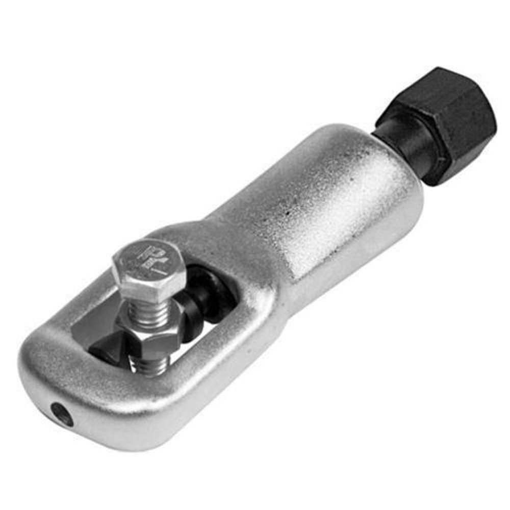

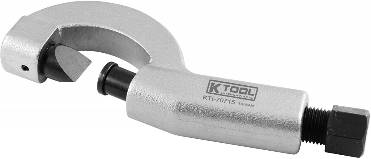

Could try one of those but splitters. I’ve never tried one, so I don’t know how well they work, but there seems to be a million different designs out there.

The splitters don't work on flange nuts, and not up close either. Best option is to grind / cut one edge down, then the other and split it manually. Inwouldn't be all that concerned about the adjuster. The stud is supposed to be fixed to the slider so you are looking at replaceing that part anyway. I would only try and save the stud if you think you can spot weld the stud from turning once you have it apart. Have to weigh the cost of a new / used slider vs the extra time it wall take to salvage the one you have.

If that doesn't work, I also say use a nut Cracker/ splitter.

This is what I was thinking. I don't think that I could spot weld it or use a torch. The bolt passes through a piece of plastic which would melt. I could cut the nut off and replace both the bolt and stud, or find someone parting out a ranger and see about getting the adjusters off of it. Currently searching for Ranger part outs.
